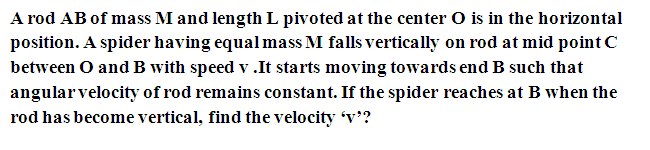

Text problem: A rod AB of mass M and length L pivoted at the center O is horizontal. A spider of mass M falls vertically on the rod at midpoint C between O and B with speed v, then moves toward end B so the rod's angular velocity stays constant. If the spider reaches B when the rod is vertical, find the velocity v.
Applying conservation of angular momentum w.r.t center O
MvL/4 = (ML2/12+ML2/16)ω , where ω is the angular speed of (rod+spider)
This gives ω = (12v/7L)
The torque τ acting on the system when the spider is at distance 'r' and the rod has rotated by an angle θ is given by τ = 2Mgrcosθ (1)
τ = (dθ/dt)(dI/dt) (2)
where I = (ML2/12+Mr2)
dI/dt = 2Mr(dr/dt) = 2Mr(dr/dθ)(dθ/dt) (3)
From the above equations I get gcosθdθ = ω2dr . Integrating I get v = (7/6)√(gL)
I don't know the answer . Is this the correct way to approach the problem ?
I would be grateful if somebody could help me with the problem .
  • Text problem: A rod AB of mass M and length L pivoted at the center O is horizontal. A spider of mass M falls vertically onto the rod at midpoint C between O and B with speed v, then moves toward end B so the rod's angular velocity stays constant. Find the spider's velocity v when it reaches B and the rod is vertical.

Tanya, your approach looks good to me. But I don't see how you get the factor of 2 in your equation (1).
Okay.
When the spider is at distance r ,the CM should be at distance (r/2) from the center .In that case torque should be (2M)g(r/2)cosθ = Mgrcosθ .
This gives v = (7√2/12)√(gL) .
Is this correct ?

I think your expression for the answer might be right. At least that's what I got with a somewhat different approach.
But, I'm not following your analysis of the torque. If you choose to find the external torque relative to the CM of the entire system, wouldn't you need to consider the reaction force at the pivot of the rod? And I don't understand the (2M) factor. Relative to the CM of the system, does the torque due to the weight of the rod act in the same direction as the torque due to the weight of the spider?
In your first post, I thought you were taking O as the origin for applying ##\tau## = dL/dt.
For example, it looks to me that your expression I = ML2/12 + Mr2 is for O as the origin.
[I like O as the origin for doing the analysis :smile:]

The CM of the system is a distance (r/2) from O .The net gravitational force acting on the CM is 2Mg(mass of rod+spider) .Hence the net torque about O = (2Mg)(r/2)cosθ = Mgrcosθ

Yes, the torque about O is τ=Mgrcosθ. But your equation (1) in the OP stated that it was τ=2Mgrcosθ.
The torques add if there are separate parts of a system. No need to determine the CM.
The rod has its CM at O. The torque of gravity is zero on it.
You did the following: Rcm=( M*0+Mr)/(2M), τ=( M*0+Mr)/(2M) * (2Mg) cosθ.
ehild
OK. I now see what you were doing. Your expression Mgrcosθ is correct for the torque about O.
The way I was looking at it: the weight of the rod acts through O, so it produces no torque about O. That leaves just the torque about O due to the spider, which is Mgrcosθ. Same as your expression.
Good!
[Edit: I see ehild already clarified it. Thanks.]
Just a small doubt .
We add torques on different parts of the system , but they should be due to external forces only . The torque due to Normal force N on spider as well as rod cancel each other .
Right ?
So if we consider the spider and rod in isolation then ,
Net torque on spider about O = Mgrcosθ - Nr
Net torque on rod about O = Nr
Net torque on the system = Mgrcosθ - Nr + Nr = Mgrcosθ
Is it alright ?

Yes. That all looks good.
For this problem the rod has constant ω after the collision. What can you say about the normal force N between the spider and the rod?
You are right, but we know that the torques of interaction cancel. Also, the torque of the force exerted by a fixed axis is zero.
Torque is due to external forces. It is gravity now. The torque of gravity on the whole system is the sum of the torques of gravity on the parts.
ehild
zero .

Yes. That was how I first approached the problem. I wondered how the spider would need to move along the rod so that it wouldn't exert a normal force on the rod. It led to the same result as your method using torque.

I considered polar coordinates (r, θ) for the spider, with O as the origin. Equation (18) here reduces to $$\ddot{\vec{r}} = (\ddot{r}-\omega^2 r)\hat{r} + 2\omega\dot{r} \hat{\theta}$$ If the normal force is zero, then the only force on the spider in the ##\hat{\theta}## direction is ##mg\cos \theta##.
So, F = ma in the ##\hat{\theta}## direction gives ##mg\cos \theta = m(2\omega \dot{r})##.
Or, ##mg\cos \theta = m(2\omega^2 \frac{dr}{d\theta})##, etc.

Yes. As you noted in post #8, the net torque on the rod about O is Nr. But the net torque on the rod must be zero since the rod has no angular acceleration.
