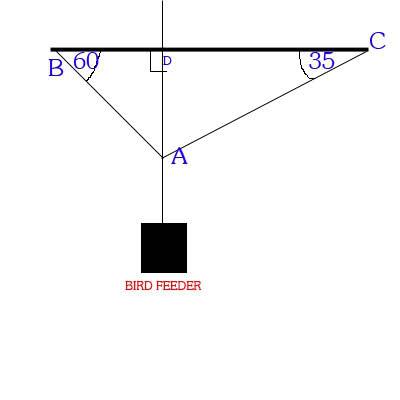

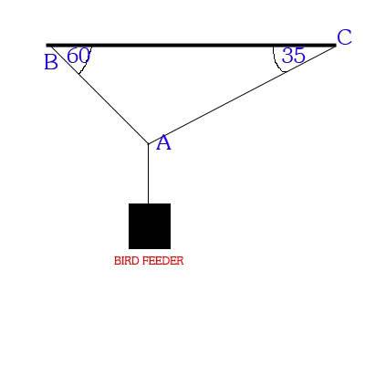

A 75N bird feeder hangs from a vertical wire that is connected to two other upper wires that are attached to a horizontal support, as shown in the figure
On a copy of the diagram, draw arrows to indicate the forces present in the wires
By considering forces A, calculate the tension in the wire AB, which rests at an angle of 60 degrees to the horizontal.
No equations given
i did this
75= Ab Sin 60
The answer is 84.6 N
but i don't think the answer is good.
What about the tension in the other wire? You can't ignore it.
84.6N is correct? I too am not sure how to do it even though the working must be something easy T.T
chrysanthemes said:
84.6N is correct? I too am not sure how to do it even though the working must be something easy.
No, it's not correct. To find the correct answer, apply the conditions for equilibrium.
