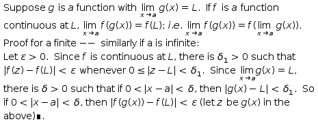

Hint: Since $\lim_{x\to\infty}\ln x=\infty$, it is the case that $\lim_{x\to\infty}(g(\ln x))=\lim_{x\to\infty}g(x)$. Also, $\lim_{x\to+\infty}g(1/x)=\lim_{x\to+0}g(x)$.
Easy helpful fact: limits slip past continuous functions. More exactly, if f is continuous and limit g(x) as x approaches a exists, then lim f(g(x))=f(lim(g(x)) -- here a can be either finite or infinite.
Application: 0=lim(f(1/ln x)=f(lim(1/ln x))=f(0)
If you're interested, here's an epsilon delta proof:
