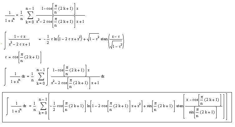

Note that the polynomials [tex]x^{n}+1[/tex] can be factorized in terms of the nth-roots of (-1), i.e, as:
[tex]x_{j,n}=e^{i\pi\frac{1+2{j}}{n}}, i=\sqrt{(-1)}, j=0,...n-1[/tex]
You can then factorize your polynomial denominator, use fractional decomposition, and perform termwise integration.
Be particularly aware of the pitfalls involved in complex logarithms.
Let us take the case with n=4.
Then, the roots are:
[tex]x_{0,4}=e^{i\frac{\pi}{4}}=\frac{1}{\sqrt{2}}(1+i)[/tex]
[tex]x_{1,4}=e^{i\frac{3\pi}{4}}=\frac{1}{\sqrt{2}}(-1+i)[/tex]
[tex]x_{2,4}=e^{i\frac{5\pi}{4}}=\frac{1}{\sqrt{2}}(-1-i)[/tex]
[tex]x_{3,4}=e^{i\frac{7\pi}{4}}=\frac{1}{\sqrt{2}}(1-i)[/tex]
We may factorize x^4+1 into 4 complex-valued first-order polynomials:
[tex]\frac{1}{x^{4}+1}=\frac{1}{(x-\frac{1}{\sqrt{2}}(1+i))(x-\frac{1}{\sqrt{2}}(1-i))(x-\frac{1}{\sqrt{2}}(-1+i))(x-\frac{1}{\sqrt{2}}(-1-i))}[/tex]
If you wish to work with real valued polynomials, multiply together the complex conjugates, and get:
[tex]\frac{1}{x^{4}+1}=\frac{1}{(x^{2}-\sqrt{2}x+1)(x^{2}+\sqrt{2}x+1)}[/tex]
A partial fractions decompositions would then proceed as follows:
[tex]\frac{1}{x^{4}+1}=\frac{Ax+B}{(x^{2}-\sqrt{2}x+1)}+\frac{Cx+D}{(x^{2}+\sqrt{2}x+1)}[/tex]
You may then determine what A,B, C and D must be by multplying the whole equation with x^4+1, getting, by rearrangement:
[tex]0=(A+C)x^{3}+(\sqrt{2}{A}-\sqrt{2}C+B+D)x^{2}+(A+C+B-D)x+(B+D-1)[/tex]
The coefficients to each power of x must be 0, yielding:
[tex]B=D=1/2, C=-A=\frac{1}{2\sqrt{2}}[/tex]
In general, your anti-derivatives will be sums of logaritms and arctan-functions.

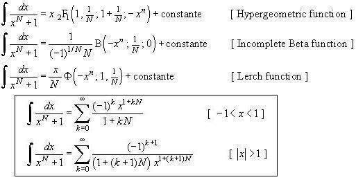

Hello !
in order to find a primitive of 1/((x^N)+1), let t=x^N and z = y/x
where z(x) is the new function to find.
This leads to z as an Euler's hypergeometric integral with variable t.
Finally, back to y and x, we obtain the solution :
y = x*F(a,b;c;X) + constant
where F is the Gauss hypergeometric function (usually noted 2F1 in the hypergeometric functions classification)
a = 1
b = 1/N
c =1+(1/N)
X = -x^N
Using the general series definition of the hypergeometric function, it is easy to express y(x) in terms of a rather simple infinite series.

Earlier on in the thread we found the same 2F1 solution as you did an infinite series representation aswell. A point was made about a finite series being more desireable though.

Hello !
I suggest you read post 9 by Gregg.
All right, but of course don't directly develop in series the general hypergeometric F(a,b;c,X) function.
First, simplify it, since parameters are particular (a=1, c=1+b). It reduces into particular hypergeometric functions of lower level : Beta incomplete (in the complex range) or Lerch function.
The series development of the Lerch function directly leads to very simple series.
(i.e. : joint page)
Of course, everybody is aware that these series can be obtained on a very simple way by developing in series 1/(1+x^N) or (x^-N)/(1+x^-N) before integration.
May be apparently !
But if the finite series contains functions like log, or polylog, or etc., each of these functions is an infinite series, so, the computation would be a finite sum of infinite series. Why only one special function like hypergeometric (or better, the Lerch function in the present case) be less desirable ?
Well, this is my viewpoint. But I understand that many people prefer using more common functions than only one special function.
