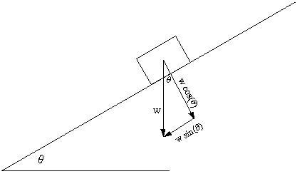

You are approaching the problem in the wrong way I think. Try resolving the forces in the problem into their components perpendicular and parallel to the plane, which would make life a lot easier for you.
The crates are on a slope, so the forces will have components that are normal to the surface and parallel to the surface. Your force due to friction with the ramp, for example, depends upon the component of the total weight that is perpendicular to (normal to) the ramp.
ƩFy = g(m1+m2)sinα
ƩFx = μk(m1+m2)g*sinα
F = (m1+m2)g(sinα-μkcosα)
Is this right ?
How can i find magnitude and direction of the friction force on the upper box ?
The trig isn't correct, try drawing a free body diagram, it always helps.
You have the frictional force, Fr, which is equal to μN, where N is the force normal to the plane, you have the force parallel to the plane due to the weight of the mass(es) and you have the force of the man pulling on the rope. The boxes are moving at a constant velocity, therefore forces up the plane must equal forces down the plane.
I have plotted a free-body diagram, but how do i know which equation i should use ?
ƩFx = Tcos27.7 (-fk)
ƩFy = Tsin27.7 + n +(-w)
Like I said, calculate the forces in the problem, from that, you should know which forces act up or down the plane, then equate them.

For the upper box:
ƩFx = Tcos27.7 + (-fk) = 0 <==> Tcos27.7 = μkn
ƩFy = Tsin27.7 + n +(-w) = 0 <==> n=w-Tsin27.7

For the upper box you won't know what the actual friction force is until you calculate the downslope component of the box's weight and compare it to the maximum static friction. This maximum is calculated just like for static friction: find the normal force and multiply by μs. What happens if the downslope component of the weight exceeds this maximum value?
I got F to be 56,39 N
fs = μn
w1 = 470.88 N
w*cosα*μs = 555,8 N tot (both boxes)
w1*cosα*μs = 222.3 N (upper box)
what am I doing wrong here ?

Only the weight of the upper box is pressing down on the lower box. The lower box is only providing the surface. What's the weight of the top box? What's the normal component?
F = (m1+m2)g(sinα-μkcosα) <==>
F = (32+48)9.81*(sin27.7-0.4444cos27.7) = 56
The upper box:
313.92*cos27.7 * 0.800 = 222.3 N

Okay, that's the maximum value that static friction can be. Now, what's the downslope component of the upper box's weight?
Im not sure
But is it
ƩFy = wCosα ?
Firben said:
Im not sure
But is it
ƩFy = wCosα ?
No, that's the normal component (that you just used to find the maximum friction). What's the component along the slope?
Is it
w*sinα <=>
313.92*sin(27.7) = 145.9 ~146 N

Yes it is.
Again, you should keep additional digits in your angle value. This will prevent rounding errors interfering with your results.
