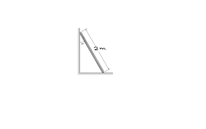

The slender ladder has a mass of 10 kg. It is released from rest in the position shown. Friction at the two contact surfaces are negligible. Determine the angular acceleration of the ladder.
I summed forces in the x,y direction, summed moments about the ladder's center of mass, wrote a kinematics equation relating the angular acceleration to the acceleration of its center of mass for a total of 5 unknowns (Force at bottom, ax, ay, angular acceleration, force at the vertical wall) and 5 equations. I have angular acceleration = 3.75 rad/s^2. This was on a multiple choice test, but there was no answer of 3.75 rad/s^2. I've been at this problem for days, making the same "mistake" over and over. I have found that the solutions manual of a similar problem is also doing the same thing I'm doing. Did my professor make a mistake?

3.75 rad/s^2 is correct.

I don't think it's possible with just one tau = (I)(alpha) equation and one constraint equation because then you'd have too many unknowns with not enough equations.
Denoting Fx as the force from wall, and Fy as the force from floor:
For forces in x;
Fx = max
For forces in y;
Fy - mg = may
And for moments about center of mass;
(Fy)(cos60) - (Fx)(sin60) = (1/12)(m)(l^2)(alpha)
The two constraint equations gave me:
ay = -(alpha)(cos60)
ax = (alpha)(sin60)
5 unknowns in 5 equations gave me 3.75 rad/s^2.

yes you can if you do it τ = dL/dt about P, the point where the normals meet …
τ = dL/dt = d/dt {Ic.o.mω + mrc.o.m x vc.o.m} = Ic.o.mα + mrc.o.m x ac.o.m

YES, so it by instantaneous axis of rotation. search it up on google if you don't know about it. it becomes very easy
