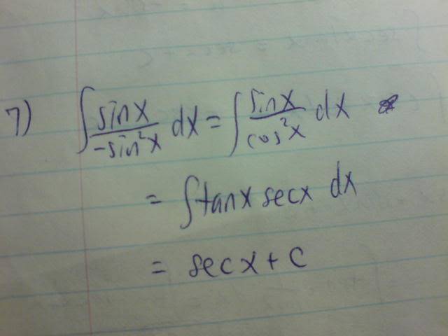

Int of sin x over - sin ^2 x of dx
I don;t know if I have the right question. But I just couldn't reproduce the problem (from my answer)!
please take a look at my note, see if you can reproduce the original question
i am talking about question #7

Is this your integral?
\int \frac{sin x}{-sin^2 x}dx
If so, this is the same as
\int -csc (x) dx
If I recall correctly, this can be done using integration by parts.
yeah i think that;s what it is
but if we use -csc x can it be done easily?
i mean cscx does not have any Anti-derv...
But -sin^2(x) isn't equal to cos^2(x), so your first step is incorrect.
then shouldn't it be int of sinx times -sin^2 x?

i am sorry, i am referring to your #4
you said my first step was wrong
now, i knew the mistake, and this is what i did
original question:
first step, change the bottom, -sin^2 (x) to this form --> 1 over csc^2 (x)
so the entire int will become
int of sin (x) times csc^2 (x)
because 1/sinx = cscx, then 1 / -sin^2 (x) = csc^2 (x)
am i correct?
You've lost a sign. -sin^2(x) = -1/csc^2(x)
Or \int sin(x)(-csc^2(x)) dx
am i correct?
No.
1 / -sin^2 (x) = -csc^2 (x)
You're going around in circles. The integrand simplifies to -1/sin x or -csc x.
It is not at all obvious how to integrate csc x. Try multiplying the integrand by a certain factor which allows you to make a substitution, but which doesn't change the value of the integrand. Hint: the final result involves a logarithm.
