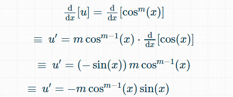

How to derive ## u = cos^{m} \,\,\, x ## ?
You use the chain rule :wink:

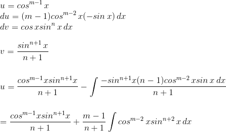

yeah , it should be ∫cosmx sinndx
Doesn't look like the expression in post #1 yet, does it ?
What could be the trick to get e.g. ##m+n## in the denominator ?
How can I ?
Fatima Hasan said:
How can I ?
You cannot. Your are being asked to show something that is false. If you let ##L## be your (corrected) left-hand-side and ##R## the right-hand-side, then trying out some small integer values of ##m## and ##n## will show that the result is wrong. For example:
