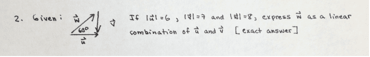

stunner5000pt
1,447
As in the diagram.
Cosine law
sine law
if we do attempt the magnitudes of u and w and the angle between them 60 degrees, I can solve for the opposite side where v is supposed to be.
I calculated
[tex]|k \vec{v}|^2 = |u|^2 + |w|^2 - 2|u||w| \cos 60[/tex]
when I calculate the above I got the value of the right side as square root 52
[tex]\sqrt{52} = \frac{\sqrt{52}}{7} |\vec{v}|[/tex]
Would this mean that to get w as a linear combination of u and v, we simply can write
[tex]\vec{w} = \vec{u} - \frac{\sqrt{52}}{7} \vec{v}[/tex]
is that correct?
Thanks for your help.

Think of this as a trig question: what are the component vectors of ##\vec{w}##? Go from there.
[tex]w_{x} = 8 \cos 60 \hat{i}[/tex]
[tex]w_{y} = 8 \sin 60 \hat{j}[/tex]
So of course x along the horizontal so
[tex]w_{x} = |u| - |v| \cos \theta[/tex]
[tex]w_{y} = - |v| \sin \theta[/tex]
But this will not yield exact answers when solved
PS are we to assume that u and v are perpendicular? That would remove the need for the above
The diagram is a little rough, but it looks as though it is supposed to be a closed triangle. If so, the given data (angle and magnitudes) are irrelevant.
You have assumed that ##\vec{u}## is parallel to ##\hat{j}## and has the same orientation, but you shouldn't make these assumptions. However, the assumption that ##\vec{u}## and ##\vec{v}## are perpendicular is necessary to make any sense of the question, I think.
