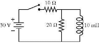

Problem 33.74
The switch in the figure has been open for a long time. It is closed at t = 0s.
PART A - What is the current through the 20[tex]\Omega[/tex] resistor immediately after the switch is closed?
PART B - What is the current through the 20[tex]\Omega[/tex] resistor immediately after the switch has been closed for a long time?
PART C - What is the current through the 20[tex]\Omega[/tex] resistor immediately after the switch is reopened?

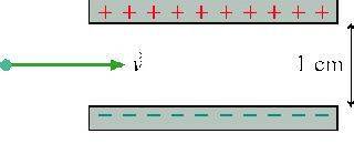

Problem 32.62
An electron travels with speed 0.900 x 10^7 m/s between the two parallel charged plates shown in the figure. The plates are separated by 1.0 cm and are charged by a 200 V battery.
What magnetic field strength (and direction) will allow the electron to pass between the plates without being deflected

Problem 33.74
PART A
I = V/R = 30/20 = 3/2 A
PART B
Same has part A
PART C
Since there is an inductor in the circuit, the current would still be there if the switch has just been opened - so same as the other two parts.
Problem 32.62
[tex]\Delta V = w v_d B \Rightarrow B = \frac{\Delta V}{w v_d} = \frac{200}{(0.01)(0.9*10^7)} = 2.22*10^-4[/tex]
For the direction, using the right hand rule that related magnetic field and speed; since the index finger points to the right, the middle finger (which is perpindicular to the index finger) is pointing out of the page.

cse63146 said:
Problem 33.74
PART A
Look at this circuit again. When the switch is first closed, that inductor is just going to block current flow down that branch. What is the total resistance that the current will run through at that moment?
PART B
Same has part A
Once the circuit with the switch closed has reached its steady-state (equilibrium) condition, the ideal inductor passes current as if it has no resistance (this is a "physics problem" inductor, not a real one...). So which branch is the current going to run through by that time? How much total resistance in the circuit does the current encounter now?
PART C
The inductor is now happily passing current freely and will not readily change from doing that. So when the switch is first opened again, will anything be different at that moment from Part B? (Your idea is right, but your answer to B is wrong.)
Problem 32.62
I would hardly call 9·10^6 m/sec a drift velocity, and I presume you're calling the plate separation w, but this result is correct. (The units are
V-sec/(m^2) = J-sec/C-(m^2) = N-m-sec/C-(m^2) = N-m/A-(m^2)
= N/A-m = T .)
The electric force on the electron is upward, so the magnetic force on the electron must act downward. Since the electron is negative, that means we want v x B to be upward. If the electron is traveling to the right in the diagram, which way must B point? (Be careful about applying the EM force rules. They are always defined for positive charges -- a favorite exam problem trap is to make the particle an electron, so students will forget to reverse the directions of the forces...)
so if the magnetic field is down, and the velocity is to the right, it would be out of the page, but sense this is an electron, it would be the opposite direction, hence out of the page?

problem 33-74 (a) ----

This is funny, but it may help somebody here. I once had a college instructor who made us repeat this like a chant: The voltage across a capacitor cannot jump instantaneously, but its current can jump. The current through an inductor cannot jump instantaneously, but its voltage can jump. Say it! Say it again!
So since the current cannot instantly jump in an inductor when the switch has been closed, then the current at that point would be 0?
We're kind of getting all over the place here. This is for Problem 32.62:
The electron would be deflected upward toward the positive plate by the electric field; if it is not to be deflected, the magnetic force supplied must provide an equal downward force. The magnetic force is given by qvB , since everything is on perpendiculars in the problem, so the sine term in the cross product is just equal to 1. But the electron is negative, so the vector for the magnetic force is given by
F_mag = -e(v x B).
This means that the magnetic force would point in the opposite direction of the vector v x B . Since we know the direction of v and the direction we want F_mag to be, we can approach this in a couple of way. One would be to point the right-hand thumb to the right for v and turn the palm so it faces downward; the fingers will point toward you or "out of the page". But this is an electron we're dealing with, so we have to reverse the direction of B; thus, the magnetic field has to be away from you or "into the page".

OK, this is for Problem 33.74(A):
Yes, since an inductor exploits Faraday's Law and resists changes in its internal magnetic field, if there is no field there to start with, it will fight the creation of one. Thus, initially, it will (ideally) pass no current, so it acts like a break in the circuit. (The "counter-emf" nearly cancels the applied current.)
What I was saying earlier is that you did not count all the resistances that the current will encounter in returning to the battery...
So when the switch is immidatly closed, the total current in the 20 [tex]\Omega[/tex] would be 0?
Just the opposite line of reasoning. Immediately after the switch is closed, ALL of the current that goes though the 10 [tex]\Omega[/tex] is forced to go through the 20 [tex]\Omega[/tex] also.
so the total resistance the current passed is 30 [tex]\Omega[/tex] which would make I = V/R = 30/30 = 1 A?
Agreed.
PROBLEM 33-74 PART A:
Your number is correct. That's the starting point of an exponential current function (I as a function of time) that begins right after the switch is closed.
PROBLEM 33-74 PART B:
The next thing to consider is: what value does that exponential decay of the current function move toward asymptotically (and actually reach only at time infinity)? The rules for transients circuits that you want to memorize is: After a "very long time" after the throwing of switches, capactors turn into open circuits (zero current through them) and inductors turn into short circuits (zero voltage across them). After a very long time the inductor will be just a piece of conducting wire. So now consider this circuit when time is infinity. The current from the battery reaches a junction where it could conceivable split into two branches, one branch being a 20 ohm resistor, and other branch being an inductor that after a "long time" has turned into a short (perfect conductor). How will that current divide between those two branches?
Once the switch has beel closed for an time t = infinite, the current would pass through the circuit with no resistance, would that make the current I = V voltage?
Is the inductor the only component the current encounters before returning to the battery?
... totally bypassing the 20 ohm resistor, as if it wasn't even there (for that brief instant).
But still another resistor that the current coming out of the voltage source will have to pass through.
I think you are wondering whether Ohm's law V=IR has an R=1, implying that V and I have the same numerical value. But you can't just select a value of R=1. Look again at the actual value of R.
But still another resistor that the current coming out of the voltage source will have to pass through. QUOTE]
So what you're saying is that it would bypass the 20 [tex]\Omega[/tex] but it would still have to pass the 10[tex]\Omega[/tex] resistor?
If that's the case then the current would be I = V/R = 30/10 = 3 A?
The circuit diagram shows that current would leave the positive terminal of the battery, passing through the 10-ohm resistor and then reach the parallel branches with the 20-ohm resistor and the inductor? So, with the switch closed, the current must encounter the 10-ohm resistor.
Agreed.
What is the circuit when the switch is opened again? How would it behave?
So far B), once the switch has been close for time t = infinite, it would have to pass through both resistors, which would make the current 1 A?
For A) The current in the 20 ohm resistor is the current of the whole circuit.
B) It won't flow through the 20 ohm. So what is the current thorugh the 20 ohm at this point then?
C) While it is 0 through the 20 ohm resistor in B, the current still flows through the rest of the circuit. So what would that current be?
(hint, it flows through just the 10 ohm resistor at one point)
