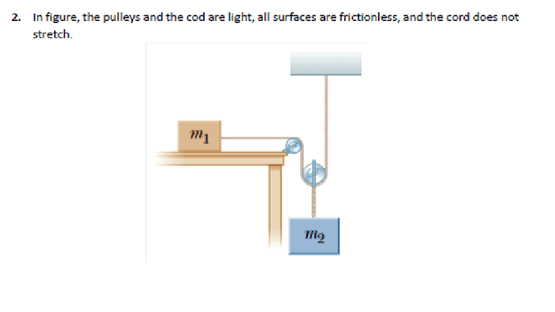

In figure, the pulleys and the cod are light, all surfaces are frictionless, and the cord does not
stretch.
a) How does the acceleration of block 1 compare with the acceleration of block 2?
The mass of block 2 is m2 = 1.3 kg. Derive an expression for the acceleration of the
block having mass m2 as a function of the mass of block 1, m1.
mg-T=m2a2
T=m1a1=m12a2
The first one (a) i have done.
Which is that due to the pulley the acceleration of a2=1/2 a1
Can some one help me with the b part

This is what i got for the derivation. But something is not right
Mass 2 equation
The pulley give 2 tensions so 2T
m2g-2T=m2a2
Mass 1 equation
T=m1a1
since a2 = 1/2a1
a1= 2a2
T=m12a2
substitute mass 1 equation in mass 2 equation as T
m2g-2(2m1a2)=m2a2
m2g-4m1a2=m2a2
make subject a2
-4m1a2-m2a2=-m2g
change negative sign by multiplying by -1
4m1a2+m2a2=m2g
a2(4m1+m2)=m2g
a2=m2g/4m1+m2
But i feel that this is not right.

mg-T=m2a2
That equation is not correct. What are all the forces on m2?
m2 would have gravity and tension

m2 would have gravity and tension those are the forces on M2
so what's next?
m2g-2T=m2a2
That's better (your post crossed with mine).
a2=m2g/4m1+m2
Looks ok to me, if parentheses inserted:
a2=m2g/(4m1+m2). What bothers you?
lioric said:
It shows the answer where g is out side a bracket. mine is in the numerator
The two are equivalent.
