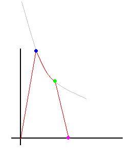

I would try to go about this problem constructing the fn as pictured below. You'd want the pink point to have limit 0 as n goes to infinity (so that fn(x) -> 0 as n -> infinity, for all x), but have it go to infinity very slowly. On the other hand, you want the blue point to go towards the y-axis very quickly, and the green point to go slowly. This will make sure that for every x, 1/x is the value of some fn because if you make the blue point go quickly and the green point go slowly, there will always be some overlap between consecutive fn's so you'll be sure to hit all the 1/x. Moreover, doing it this way, you should be able to have the area under the graphs grow as n increases, which should ensure that the integral of the functions as n goes to infinity is infinity.
This suggestion is thus far my only clue, and best hope. It is unfortunately impossible, (assuming that the curves from 0 to the blue dot, and the segment from the green dot to pink dot are linear segments).
Do the curve fitting, make the integral go to zero, and retain the upper bound I require three sequences which satisfy impossible inequalities.
I mean not to complain. Thank you.

Would it help to have fn(0) not be 0 for all n, rather let it be some number that approaches 0 very slowly? Actually, no, I suppose it wouldn't. It would only contribute an extra triangle of decreasing area.
Actually, I think something similar might work, however, it seems so similar to the previous suggestion that either I'm wrong that this one will work or I'm wrong that the previous one doesn't work. Suppose my original suggestion for fn was a linear map on [0,1/n]. We want to add something on to this, but let everything to the right of 1/n remain the same. Now the line segment from (0,0) to (1/n,n) has slope n². Draw a line parallel to this line segment, intersecting the y-axis at n-1/4. Also, draw a line parallel to the x-axis, intersecting the y-axis at n. Now the y-axis, the two lines we just drew, and the segment from (0,0) to (1/n,n) form a trapezoid. I believe that the height of this trapezoid is on the order of n-3/4. The segment (0,0) to (1/n,n) has length on the order n. So the area is on the order of n1/4. This goes to infinity as n goes to infinity, as desired.
On the other hand, over half of this trapezoid is the triangle I suggested before. But that triangle would have a base of n-1/4 and a height of 1/n, so it's area would be 0.5n-5/4 which goes to 0 as n goes to infinity. So what's wrong here?

I think some modification of the thing in post #12 should work. If you look at each fn having three parts: 2 triangles and the 1 area bounded above by 1/x, then make the area in the middle go from x=1/(n+1) to 1/n. This will contain an area of log(n+1/n) which of course goes to 0 as n goes to infinity. Instead of having the left-triangle have one vertex at (0,0), give it a vertex at (xn,0) where xn is so close to 1/(n+1) that the area of the triangle goes to 0:
0.5(n+1)(1/(n+1) - xn)
= 0.5(1 - xn(n+1))
So you want to choose xn such that 0 < xn < 1/(n+1) but such that xn(n+1) -> 1 as n -> infinity. Try xn = (n + 1 + n-1)-1. Do something similar for the right side triangle.
I had a similar idea, only I used fixed end points (that time), but I had the problem that the right leg of the right triagle went above 1/x for certian values of n using the [1/(n+1) , 1/n] interval for the portion under 1/x.
I am thinking that this way too much work without using any theorems, then again, it is a grad class and my prof. tweaked the question from the text. I'll check out your lastest post: thank you very much AKG!
The slope of the 1/x curve at x=1/n is -n². If you are at (1/n,n) going down at a rate of -n², you will hit the x-axis at x=2/n. Choose a point for the right-most point of your right triangle between 1/n and 2/n. You shouldn't be choosing something bigger than 2/n in the first place. I would recommend something like (n - n-1)-1. The area of this triangle would then go to zero as n increases.
