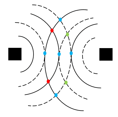

Two speakers are positioned facing each other 16m apart.
Draw a diagram representing the compressions (whole lines) and rarefactions (dashed lines) of sound waves radiating outwards. Mark several areas of constructive and destructive interference.
sound waves
I have tried to draw the diagram and would just like feedback on it to know whether it is correct or not.
Please keep in mind this was done roughly. Thanks

How about explaining what the colored dots mean? It's your diagram, no?

blue dots are constructive interference and red dots are destructive interference. I just realised that there should only be two colors of dots and not three. Assume green dots are also red.
Are the speakers supposed to be out of phase?
they are coherent
Coherent means that the phase difference is constant. Any constant. Your drawing seem to assume a phase difference of 180 degrees.
Apologies for the misunderstanding. Yes they are out of phase
Solid lines are compressions, OK.
Dashed lines are rarefactions, OK.
It follows that solid and dashed lines are 180° out of phase.
Does it follow that at the green dots, where two dashed lines are superimposed, you should have a red dot instead indicating destructive interference?

If they are both dashed they are in phase. Half a period later the same point will be reached by two solid lines. The amplitude of the pressure at the point has maximum value. At the constructive interference there is maximum rarefaction too.
