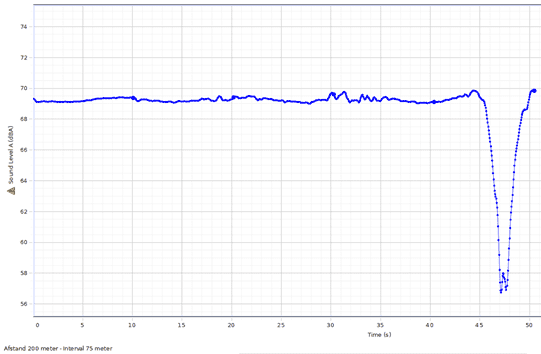

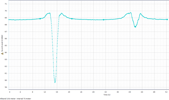

I collected this data by moving a sound level meter slowly through a total length of 0,75 meter between two speakers pointing towards each other. The wavelength of the sine waves was 0,343 meters and the frequency was 1000 Hz. The sound level meter measured the sound in dbA 20 times a second.
Can anyone explain why there's no constructive interference at all?

What was the signal you used? For a sine wave, the expected signal would be hard to predict because the levels from each speaker could vary a lot, over the distances from the speakers, preventing an ideal interference pattern but I would have expected a sort of standing wave pattern. What happens if you invert the phase of one of the speakers? Do individual runs for each speaker alone and see how the signal level varies with distance. When you get results that you think are really odd, there's often something seriously wrong with the set up so you have to try changing things one at a time and 'follow your nose'.

Thanks for the answer. Unfortunately, I do not have more time to make the experiment again. Do you have any ideas why I didn't get that standing wave pattern? According to the theory, there should be constructive interference at the center, but nothing happens in the data I've collected... I hope you can help :)
I think the explanation could be partly down to the logarithmic (dB) scale that's being used. You may not b e too familiar with using dB scales and they don't always say what you think they are saying. In addition there is variation of signal levels from the speakers as you move between them.
On the two traces, the cancellation is only around -10dB. That is a reduction in amplitude to 1/3. The ratio of the two amplitudes at the actual point of cancellation would only need to be 3:2 - leaving 1/3. The sum would be 1.67, which corresponds to only +4dB. So, on the dB scale, you wouldn't expect a massive peak (only 6dB and a minimum of several tens of dB if everything went right.
For a normal standing wave pattern, the waves in both directions have a constant amplitude all along the 'string' or tube carrying the waves. Your model of two point sources is not the same. If you were to plot a graph of expected signal levels from each speaker (inverse square law perhaps) as you traverse the path between (did you check this?) and work out the possible sum and difference values at a number of points in between the speakers, you will only get good addition and subtraction in some places. [Edit: actually, only in one place]
Are you sure of the wavelength that you were using? It may be that the humps on either side of the dips are actually 1/4 wavelength from the only dip that is actually occurring because of the varying signal levels.
I don't really understand this. Why wouldn't I expect the intensity of a constructive interfernce to be equal to the destructive? Could you perhaps elaborate it?
I don't see how the variation of signal levels through out the path between the speakers can cause the problem? Doesn't the sound level only affect the amplitude of a wave? And could sound that reflects from the walls be a part of the problem?
This is not an ideal situation and you need to realize that your ideas about a well designed experiment will not apply.
When two signals interfere destructively, the sum can be Zero. When they interfere constructively the result will be twice the amplitude. On a dB scale, this will look like -60db (or whatever the sensitivity is) to +6dB. So the trace will never be symmetrical on a log (dB scale). You will only get perfect cancellation when the signals have equal amplitudes. The two signals will only be equal in just one place when using two loudspeakers. A point source will not produce a uniform level and, on the way in between, one is going up and one is going down.
Reflections from elsewhere can have a big effect (which is why it's best to do this sort of thing in a 'dead room' or outside on a quite day. Better still, as I suggested, it should be in a tube or trunking so the levels from each loudspeaker. do not change with distance. When you are away from a node, the resulting amplitude will be somewhere in between the difference and the sum. The maximum is much wider than the minimum and, as you say, there can be reflections from walls to mess it up further.
Your results show a minimum that is not in the centre. That is probably because the output levels from the two speakers are not equal. Away from that point, only one speaker will dominate.

How did you find out that a cancellation of -10dB is a reduction in amplitude to 1/3?... but I just don't understand why the contructive interference only can raise by 6 dB, while destructive can go all the way down to zero.
The decibel scale is nonlinear. Doubling the amplitude increases the the decibel level by 6dB, reducing the amplitude by a factor of 3 lowers the decibel level by 10dB. The Wikipedia article on "decibel" will explain this in more detail.
Do you know the dB scale you have been quoting on your diagrams? I wonder who gave you the equipment without telling you how to use it.
The maximum resultant from two signals (when they are co-phase) is 2A. Twice the amplitude corresponds to 6dB. If the signals are not in phase and not equal in amplitude, the resultant will be less than that. You should read about these dB things. They are universally used in signal measurement. This wiki link has all the information and has the formulae for conversion. I really can't think of a non mathematical way into this. Do you understand about the way waves add in a situation where they are of different amplitudes and an arbitrary phase?

Thanks to both of you, It makes a bit more sense now. I now understand why constructive interference only can go up 6 dB.
If I reduced the sound in dB all the way to zero by making destructive interference, how much would I then have reduced the amplitude? And no, I don't understand the way waves add in a situation where they are of different amplitudes and an arbitrary phase.
