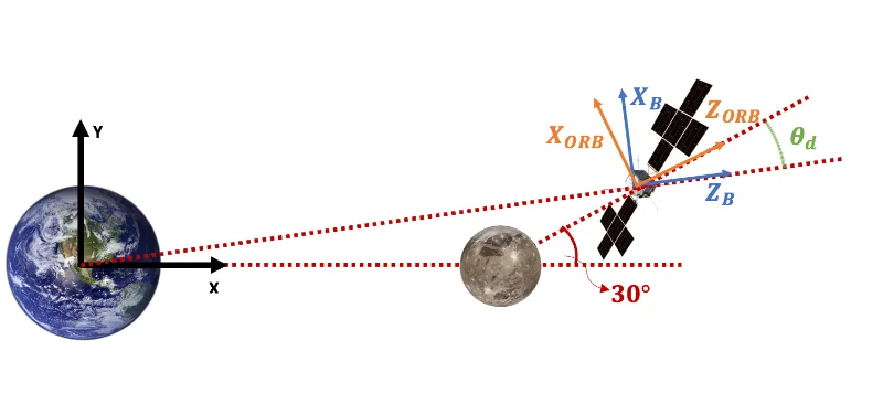

Good morning,
I have this homework attached as PDF with also a more explanatory image wrt the one in the PDF.
I tried to solve it (my code is attached below) but I get nonsense results. Could someone explain errors and fix my code? Unfortunately I'm not so good at MATLAB

This is the code in txt format. As nonsense results I mean that as output I get something that does not meet the requirements given by the homework.
I think you will need to give much more information if we are to be able to help you. Can you comment on how you are implementing the attitude control system, and also comment on this from the assignment:
1. Evaluate all the disturbance torques acting on the spacecraft along the pitch axis during this
time. Plot the evolution of the pitch angle in the absence of control torques.
2. Design an attitude control system compliant with the flight rules. Provide in the report the
constants describing the control algorithm. Comment on your choice and plot all relevant
quantities (offset angle and rate, wheel angular speed, torque, current and power).
After 1 hour the spacecraft experiences a minor malfunction of the attitude control thrusters that
causes a constant disturbance torque of 0.008 Nm along the spacecraft Y-axis.
3. Calculate how long the pointing window can be extended using the same control law designed
before, considering this new disturbance acting on the spacecraft. Report at which time from
𝑡" a desaturation maneuver becomes necessary.
4. Design the maneuver to maximize the interval between two consecutive desaturation
maneuvers. Consider a maximum pointing error of 1° only during the desaturation maneuver.
Report the time needed for the desaturation, plot and comment the results.
