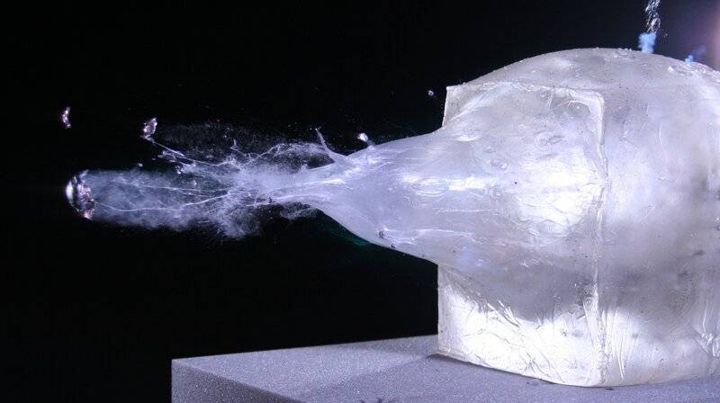

  • #40
PeterDonis said:
very quickly
Of order an hour.
It will have comparable force to the sun at about 11 light-minutes coming in and 11 light minutes going out, making 22: 23 with rounding. You get half the solar effect at √2 farther out, and a quarter of the effect at a factor of 2, and so ojn. So the scale is around an hour.
We're talking 1/10,000 of Earth's orbital period, so we would expect 0.01% changes to the orbit. That's 10,000 miles. I have no idesa how to calculate what would happen if this happened, but I suspect it would wreck everybody's day.

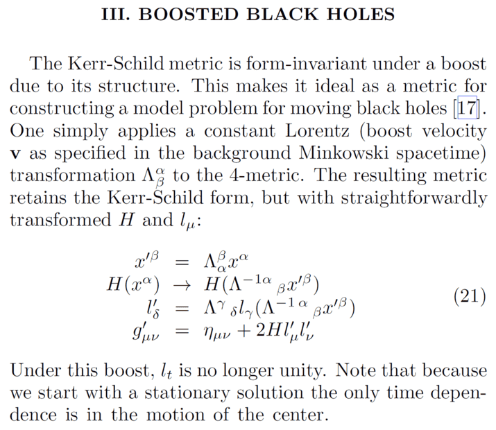

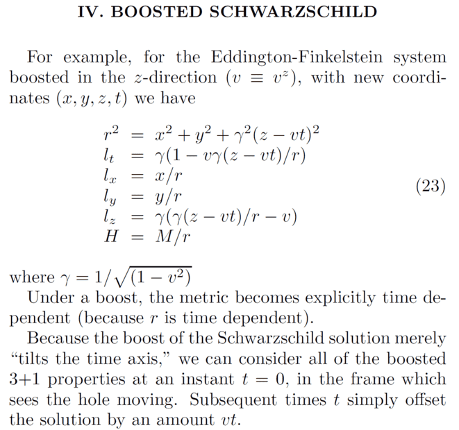

  • #50
While I don't recall how the paper did the calculation anymore, what comes to mind is considering the Schwarzschild solution in isotropic coordinate (t,x,y,z), perform a coordinatge transformation to cylindrical coordinates, (t, r, theta, z), then perform an additional coordinate transformation of z' = z - ##\beta## t to make the large mass "move" in the z direction in the transformed coordinates.
While one could also use isotorpic Schwarzschild (t,x,y,z) coordiantes directly, and do the z' = z-##\beta## t coordiante transformation without first going to cylindrical, the cylindrical coordinates will be simpler as the problem has cylindrical symmetry. The basic insight is as my previous response suggested, it's just a messy coordinate change of the problem of the deflection of an ultra-relativistic particle. Then the particle follows a geodesic in the transformed coordinates.
It's likely that one would only want to consider the linearized problem - so rather than using the full non-linear isotropic solution, one just considers the linearized version thereof.
  • #51
pervect said:
he effect is essentially viewing this scenario from a set of coordinates where the ultra-relativistic particle is nearly stationary, and the large mass is moving instead.
But in these coordinates, while we would certainly expect the particle to be deflected, we would not, it seems to me, expect the system of large masses (the solar system in this case) to be disrupted. We would expect its configuration to be basically the same after the flyby as before--because in this frame the particle has negligible effect on the spacetime geometry.
However, a flyby of either a one solar mass object or a two solar mass object (meaning, the total energy of the object taking into account that in the solar system frame it is moving at a tiny smidgen less than the speed of light) through the solar system would be expected to disrupt the solar system, not just deflect the object.
So we still have a disconnect here: in one frame (the object's rest frame), we expect no disruption of the solar system, but in another frame (the solar system rest frame), we do. So the intuitive reasoning described above must be wrong in at least one frame.
