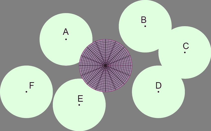

Suppose a black hole with a radius equal to the radius of the observable universe exists and a fleet of coasting spacecraft are moving directly away from the black hole (along a similar vector) at very close to the speed of light with an amount of kinetic energy A with respect to the singularity that is very much greater than is necessary for escape velocity. Each spacecraft is emitting flashes of light evenly in all directions at regular intervals at a pre-agreed frequency.
As the value of A = kinetic energy per craft increases to arbitrarily higher values in various scenarios, will a greater % of photons become redshifted by gravitational redshift in transit between spacecraft as a result of the relativistic aberration, compared to scenarios where the value of A is much lower or in fact 0?
If we cut off some unessential stuff and some problematic stuff, then there is a gravity field and some free-fallers that send signals to each other. For those free-fallers everything works like there was no gravity field.
So the question has been answered. Free-fallers do not observe redshifts.
Well perhaps we, "outside observers", want to even better understand why the free-fallers did not observe redshift, although we can observe a redshift occurring by dangling some measuring devices at the locations where the signals are emitted and absorbed?

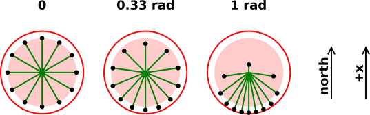

Let me recap. In the scenario there is a black hole with a radius of the observable universe and a fleet of coasting, co-moving ships with a variety of heights above the black hole and a variety of separation distances between them, but they are in a region of space roughly 2 black hole radii from the geometric center of the black hole, and the co-moving velocity of the ships is on a vector directly away from the black hole at an arbitrarily high speed close to the speed of light (co-moving at 0.999999999999999995c or greater in various different scenarios) with respect to the black hole. The only observers are the co-moving astronauts on the ships, and the ships are emitting flashes at regular intervals, equally in all directions, on a pre-agreed frequency.
Questions:
Will the relativistic aberration cause a higher and higher % of total photons to travel on vectors which increase in distance from the black hole over time, as the ships co-moving velocity increases in different scenarios?
In a given scenario (for example if 99.99999999999999% of total photons are moving away from the black hole), will the photons become redshifted from gravitational redshift during their flight times between craft?
^If yes, Will the measured gravitational redshift increase (as measured by an observer on one of the craft) as the separation distance between the craft increases in different scenarios (longer flight times between craft)?
From the point of view of an observer "hovering" at rest relative to the hole, yes. Aberration depends on relative velocity.
As above, you need to do the math and see if you want to know for sure. But intuitively, we can look at it from two points of view:
From the point of view of the ships, they are all in free fall and are all at rest relative to each other, so there is no such thing as "gravitational redshift". However, if their separation is large enough, spacetime curvature might be detectable between them during the time of flight of a particular photon, which would mean the logic of the previous sentence wouldn't be quite right (since it assumes that the entire fleet can be contained within a single local inertial frame during the flight time of a photon).
From the point of view of an observer "hovering" at rest relative to the hole, since all of the spaceships are in free fall, they are decelerating, so while a photon will have gravitational redshift as it travels upward, the ship that receives it will have decelerated during its flight, which will cause a compensating blueshift (which is an effect I didn't think of when I originally posted about gravitational redshift). However, without doing the math, we don't know for sure that those two effects exactly cancel (though it seems intuitively like they should).

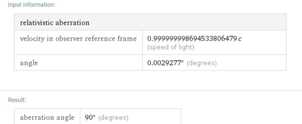

I've tried something similar before:
metastable said:
Source: https://en.wikipedia.org/wiki/Relativistic_aberration
cos(angle observed to source) = (cos(motion path angle relative to the vector from the observer to the source at the time when the light is emitted)-(V/C))/(1-((V/C)*cos(motion path angle relative to the vector from the observer to the source at the time when the light is emitted)))
A = cos(motion path angle relative to the vector from the observer to the source at the time when the light is emitted)
B = V
C = C
D = cos(angle observed to source)
D = (A-(B/C))/(1-((B/C)*A))
A = -1*(((-1*B)-(D*C))/(C+(D*B)))
P = 299792457.608631081048 m/s = 10gev + 1ev electron velocity lab frame
Q = 299792457.608631080969 m/s = 10gev positron velocity lab frame
V = 299792457.6086310810085 = (P+Q)/2 = Velocity of Center of Mass observed from Lab Frame
B = 299792457.6086310810085
C = C = 299792458m/s
D = cos(angle observed to source) = 0 = cos(90deg)
A = -1*(((-1*299792457.6086310810085)-(0*299792458))/(299792458+(0*299792457.6086310810085)))
A = 0.9999999986945338064792 = cos(0.00292766)
0.00292766 degrees = motion path angle relative to the vector from the observer to the source at the time when the light is emitted
