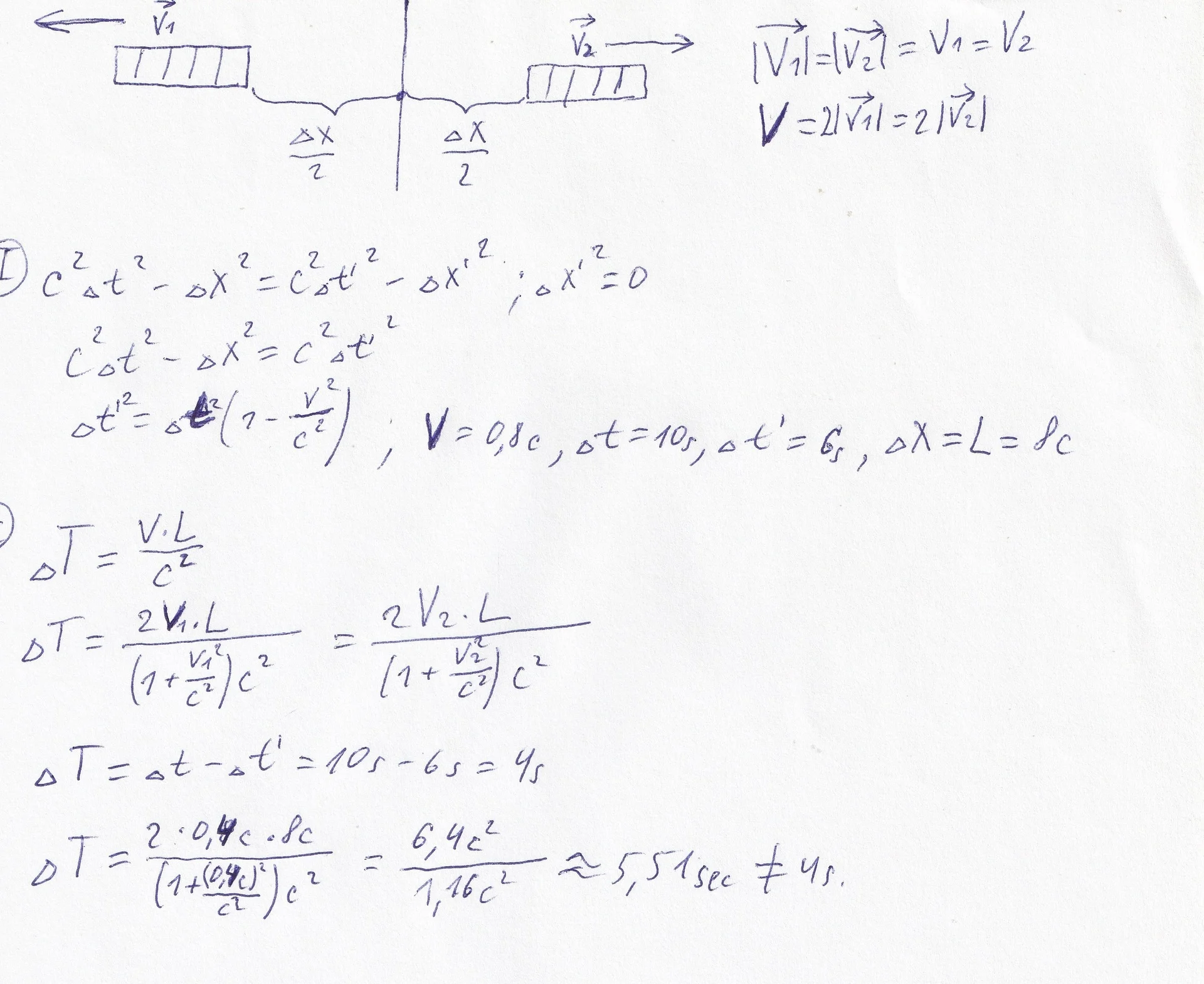

In your calculation, what are the primed and the unprimed variables?
In the first section after the picture you are calculating two spacetime intervals and setting them equal to each other. Which spacetime intervals are being calculated and why are they equal?
In the second section, it is unclear where the initial formula arises.
##\Delta t## is primed variable, ##\Delta t'## is unprimed variable.
Left side of equality: view from left train (rest frame); right side view from right train. They are equal because of invariance of interval.

Yes, but what do they mean? Typically primed variables represent one frame and unprimed variables represent another. But which is which? Especially since there are three frames of potential interest here.
##\Delta t## is time on the left clock (in the left train which at rest). ##\Delta t'## is time on the right moving clock.
Dale said:
Views of what? The spacetime interval is calculated between two events. Which two events? To invoke the invariance of the spacetime interval it must be the same two events on both sides.
Event1: reading the left clock ##\Delta t## when distance between left and right clock is ##\Delta x##
Event2: reading the right clock ##\Delta t'## when distance between left and right clock is ##\Delta x## (##\Delta x' =0##)

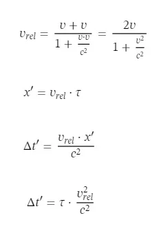

Perhaps. I found different formulas and explanations how to find "value of desynchronization" but they didn't work. The simplest working formula was ##t_A-t_B## 😂
Mike_bb said:
My calculations are here. The rest frame - left train. I obtained wrong result (5.51sec instead of 4sec) .
Could anyone explain where did I go wrong? Thanks!
Dale said:
At the end of that first section you have Δx=L=8c, which Δx should be a length but 8c is a speed.
Mike_bb said:
##8c##=8*300000. I denoted "c" as dimensionless unit in this case (for convenience).
Dale said:
In the second section the formula ΔT uses a capital T instead of lower case t. Is there any significance to that?
Mike_bb said:
This formula is used for calculating "effect of simultaneity". I don't know how to say this in English.

##V = \frac{2v_1}{1+v_1^2/c^2}##
Mike_bb said:
##V## is relative velocity of moving trains.

OK, so the events are described in terms of ##\Delta x## which is in the unprimed (left) train's frame. In the left frame the worldline of the left clock is ##(c t, x) = (c t, 0)## and the worldline of the right clock is ##(c t, V t)## where ##V=2 v/(1+v^2/c^2)##. I think you are using ##v=0.4 c## so ##V=0.69c##. Anything using ##V=0.8c## will be wrong.
Now, at ##t=10## we can simply substitute into the worldlines to get the events. Event 1 is ##E_1=(c 10, 0)## and Event 2 is ##E_2=(c 10, V 10)=(c 10, c 6.9)##. So ##c\Delta t = 0## and ##\Delta x = 6.9 c##. This gives a spacetime interval of $$c^2 \Delta t^2 - \Delta x^2 = 0 - 100 V^2 = -47.6 c^2$$
This is great but, since we do not already know ##\Delta t'## nor ##\Delta x'## it doesn't really get us much information. It is definitely not correct that ##\Delta x'=0##.
We can transform into the primed frame to find that information. Taking the Lorentz transform of ##E_1## and ##E_2## we get ##E_1'=(13.8 c, - 9.5 c)## and ##E_2'=(7.2 c, 0)##. So ##c\Delta t'=6.6 c## and ##\Delta x'= -9.5 c## which gives a spacetime interval of $$c^2 \Delta t'^2 - \Delta x'^2 = -47.6 c^2$$
I am not getting anything that looks like your ##\Delta T##, but it is hard to tell with some things using numbers and some things using variables. But the big mistakes that I see are assuming that ##\Delta x'=0## and that ##V=0.8c##, which lead to some other follow on errors.

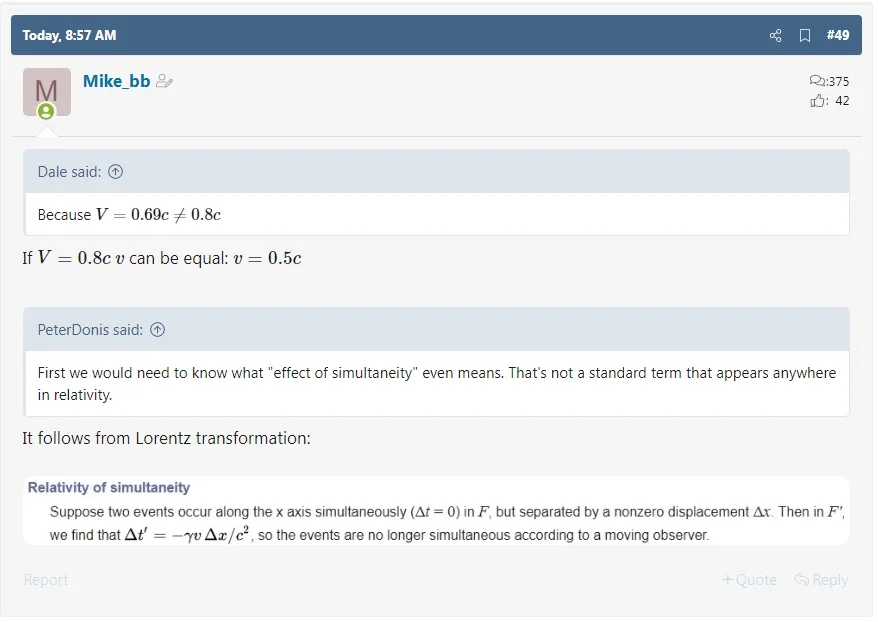

PeterDonis said:
First we would need to know what "effect of simultaneity" even means. That's not a standard term that appears anywhere in relativity.
It follows from Lorentz transformation:
Mike_bb said:

I don't understand what you mean. I changed nothing. I just said that ##v## can be equal ##0.5c## and then ##V=0.8c## (but you wrote that it's wrong(?)).
##V=0.8 c## is wrong with ##v=0.4c##.
