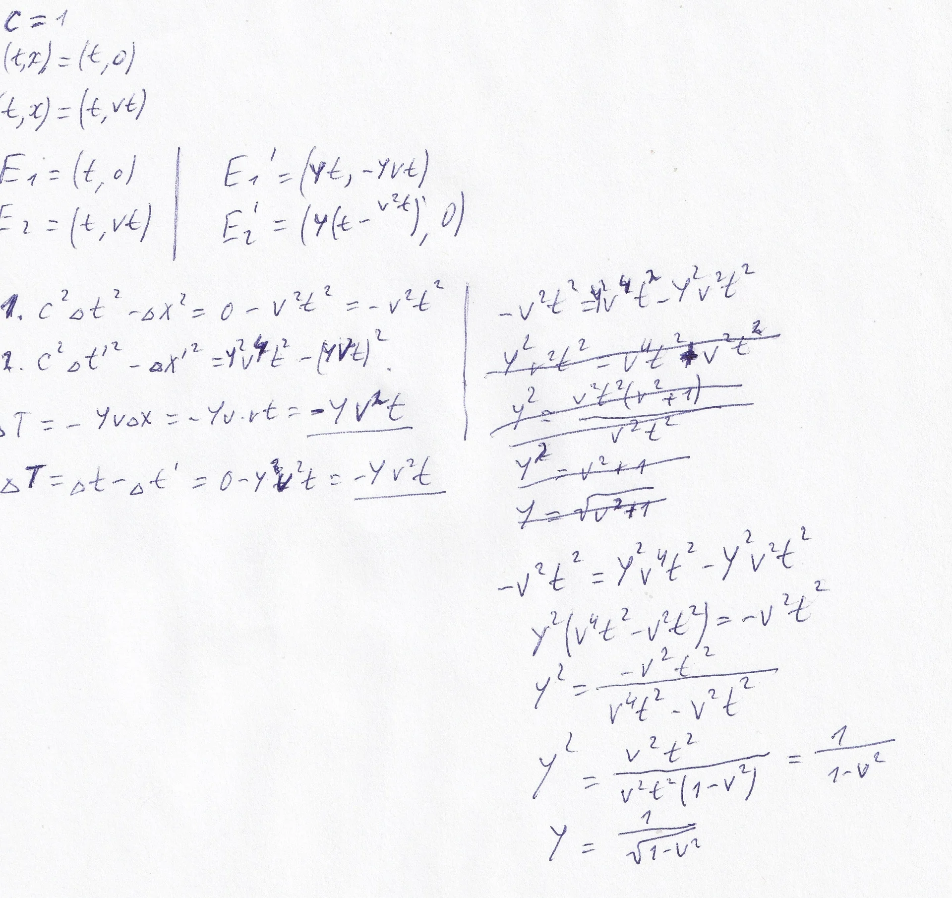

Ok. If I need to, I will do it.
I wouldn’t recommend trying to redo the same analysis with different numbers. I would do the following:
Start with the left train’s frame and using units with ##c=1##. In that frame the left train has a worldline ##(t,x)=(t,0)## and the right train has a worldline ##(t,x)=(t,vt)##. Pick an event on the left worldline and find the event on the right worldline that happens at the same time in the left frame.
Then transform those events into the right frame and calculate the difference in time. All symbolically, don’t use any numbers.
