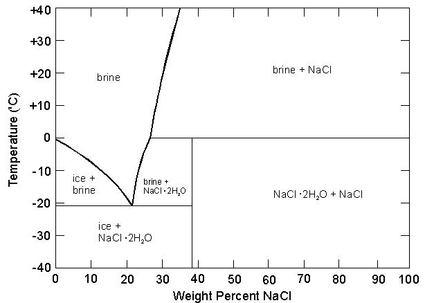

It's possible to calculate the latent heats of fusion and the specific heat of a solution of H2O and NaCl?
In some cases, it would have two latent heats of fusion? For example, at 10% NaCl, one at -21ºC and another at -5ºC?

Yes, the heat of fusion will be a function of the concentration of the brine.
Thank you DrDu. I guess that heat of fusion will be at -21ºC, but If I have 10% of NaCl, would I have another different heat of fusion at -5ºC, or it would be the same?
Thanks!
With a 10% solution there is no NaCl formation at either of these two temperatures. The heat of fusion comes into the calculation only on the line between brine and brine + NaCl .
Likes Serena
Well, thank you BvU. But for me it's interested what happened on the left of eutectic point. I could calculate the latent heat of fusion of ice+brine?
You form ice and the composition moves towards the eutectic point when cooling further.
You can do so, at least for 0% concentration. For very small concentrations, the chemical potential of water in the liquid phase follows Raoult's law ##\mu_l(T,x)=\mu_{l0}(T)+RT \ln(x)## where x is the molar fraction of water in brine. Pressure is constant, so I don't mention it any further. The chemical potential of the solid phase, which consists of pure ice, is ##\mu_s(T)## and depends only on temperature. Now on the melting curve, ##\Delta G=\mu_l(T,x)-\mu_s(T)=0##. We can now use a Taylor expansion for ##\mu(T,x)## around ##\mu(T_0,1)##, where ##T_0## is the melting point of pure ice. We know that ##\partial \Delta G/\partial T|_{P,x}=\Delta S=\Delta H/T_0## and ## \partial \Delta G/\partial x|_{T_0,P}=-RT_0 (1-x)##. So ##0=\Delta G=(\Delta H/T_0)\cdot \Delta T -RT(1-x)## or
##\Delta H=RT_0^2(1-x)/\Delta T##. In the calculation of x, you have to take into account that NaCl will dissociate into sodium and chloride ions.

Well I'm back! I would like to resolve this exercise so...
For example, applying this formula to a solution with 10 wt% NaCl (0.17 mol NaCl), which has a T0 = 268 K, ΔT = 1 K and R = 8.31 J/(molK); I have ΔH = 495392 J
Now with n = 1 mol, and ΔT = 1 K:
Cp = ΔH/(nΔT) = 495392 J/(molK) → 8470*103 J/(KgK)
So this would be the specific heat of a solution with 10 wt% NaCl in water at -5 ºC. But this huge number has no sense... something I'm doing wrong, could you help me?
