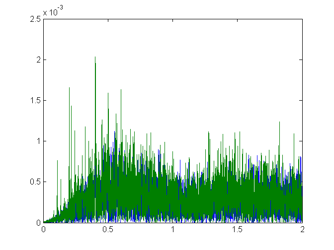

thank you very much for the suggestion to use a band pass filter. i have tried it, but it merely filters out the band passed part of the spectrum without changing the amplitudes (see attachment). the data was generated with sines with amplitudes 0.37 and 0.24, added with normally distributed random numbers of std dev 1.
DFT seems to produce amplitudes that are slightly biased. the mean amplitude of the 0.37*sin term of 10000 repetitions is 0.3756 with std deviation 0.0439. i can live with the slight bias, so i guess what I'm really looking for is a method that gives me unbiased or slightly biased amplitude estimates with lower standard error than DFT.
i will definitely look into welch's method, thanks for the suggestion. it's also very convenient since it is already implemented and ready to use in matlab.
i do know a lot about the noise. the noise in every data point is normally distributed (with known variance), but the noise terms happen to be slightly correlated with each other. maybe this could be a problem too?
unfortunately, i don't know anything about the signal. in fact, i wish there was no signal at all! you see, my problem is to check whether signals are present, and in the unfortunate case where there are, i need to estimate their amplitudes. i will also look into the burg method, but I'm afraid my limited knowledge of statistics will not get me very far. thank you very much for your detailed explanation, i certainly learned a lot.

the graph that i showed previously used randomly generated data. data from an actual measurement is attached with this post. note that the data is not stationary, it doesn't have zero mean. i need to know whether there are vibrations "on top" of the curve, so i first subtract the moving average (window size 11), and then do the dft.
thank you very much for your help!
