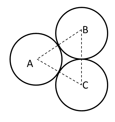

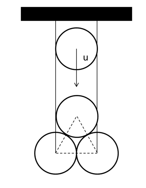

Two equal spheres of mass m are suspended by vertical strings so that they are in contact with their centres at the same level. A third equal sphere of mass m falls vertically and strikes elastically the other two simultaneously so that their centres at the instant of impact form an equilateral triangle in a vertical plane. If u is the velocity of m just before impact, find the velocities just after impact and the impulse of tension of the strings.
After collision, the hanging spheres will gain velocity along the direction of common normal of spheres. (Common normal is the line joining the centres of sphere)
See attachment 2 (I haven't shown the strings and rotated the figure).
Conserving momentum in x-direction,
##mu=mv'+2mv''\cos(\pi/6)##
From the equation of coefficient of restitution,
$$e=\frac{\text{Relative speed after collision}}{\text{Relative speed after collision}}$$
The relative speed before collision is ##u\cos(\pi/6)## and after collision is ##v''-v'\cos(\pi/6)## and for elastic collision, coefficient of restitution is 1. Plugging and rearranging,
$$v''-v'\cos(\pi/6)=u\cos(\pi/6)$$
Solving the two equations I have doesn't give me the right answer. :(
Any help is appreciated. Thanks!

Clearly the hanging spheres are constrained to move horizontally immediately after the collision. So their strings must have impulses preventing any vertical motion, just like the problem indicates.
So do I assume that after collision, the hanging spheres have velocity in x direction and conserve momentum again?
On your diagram, the x-axis is vertical. As I said, the hanging spheres have no motion vertically: it is prevented by the strings.
Sorry about that but what should I do now? I don't really know how to begin.
One thing to observe is that momentum is not conserved in vertical direction because of the impulsive tension in the strings; this yields an equation. Momentum is conserved in the horizontal direction, which has an immediate consequence (which is also obvious from symmetry). Energy is conserved, too.
And which equation is that? :confused:

Let the sphere has velocity v' in the vertical direction after collision.
Are you talking about direction AB? Change in momentum of striking sphere in that direction is ##mv'/\sqrt{3}+mu/\sqrt{3}##. The tension is in vertical direction and momentum of hanging balls in the horizontal direction. How do I relate them? :confused: :cry:
  • Diagram of three equal circles touching pairwise, with centres A, B and C joined by dashed lines forming an equilateral triangle; the circle at A is on the left, B is upper right and C is lower right.
I = incoming momentum (AB direction)
R = recoil momentum (AB direction)
S = hanging ball momentum (horizontal)
T = impulse of tension (vertical)
Total change of momentum: R + S - I.
Total impulse: T.
So?

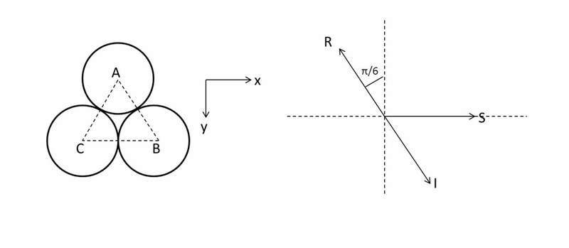

Okay, I am redefining the coordinate system to make things easier. The vertical direction is y-axis and horizontal as x-axis. Sorry for the inconvenience, I should have done this from the beginning.
I have drawn a vector diagram showing R,S and I. Change in momentum is:
$$\vec{T}=\left(mv''-\frac{mv'}{2\sqrt{3}}-\frac{mu}{2\sqrt{3}}\right) \hat{i}+\left(\frac{mv'}{2}+\frac{mu}{2}\right) \hat{j}$$
What should I do now? :confused:
  • Left: three equal circles touching pairwise, centres labelled A (top), C (bottom left) and B (bottom right), with x and y axes shown to the right. Right: vectors R, S and I from a common origin, with a dashed vertical line and an angle labelled pi/6 between R and the vertical.

Perhaps a more systematic solution would first consider the falling ball alone. At impact, it experiences two impulses from the hanging balls, so U - D = N1 + N2, where D is the downward momentum, U the upward momentum, and N1 and N2 are impulses of the normal forces from the hanging balls. Then for each hanging ball S = -N + T.
Tanya Sharma said:
What is the initial and final momentum of the hanging mass(left mass) in the vertical direction ?
Zero.
Let ##N_1## be from the left ball and ##N_2## be from the right ball. Then
$$\vec{N_1}+\vec{N_2}=(mv'+mu)\hat{j}$$
$$\vec{T}-\vec{N_1}=-mv''\hat{i}$$
$$\vec{T}-\vec{N_2}=mv''\hat{i}$$
Are the above equations correct?
Assuming you follow the sign convention for u and v' consistently, those equations should be fine (I hope). That's a lot more unknowns than before, though.

Impulse due to tension can be found using the equations above, add the second and third. It comes out to be the same expression as #20. But I still need one more equation.
The equation in post #20 reduces to T=(mv'+mu)/2 using the fact that tension is purely vertical. So I got one more equation from there by equating the x-component to zero. How do I obtain the same using this method?
