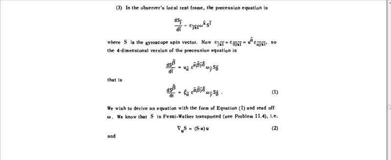

Hello. I was going through the problems in the angular momentum chapter of the text "Problem Book in Relativity and Gravitation"-Lightman et al in preparation for a project and I came upon part (c) of problem 11.10. It basically starts with a family of observers with 4-velocity ##u^{\mu} = (-\xi_{\gamma}\xi^{\gamma})^{-1/2}\xi^{\mu}##, where ##\xi^{\mu}## is a time-like Killing field, and a Lorentz frame ##\{e_a \}## Lie transported along ##\xi^{\mu}##, and asks to show that the angular velocity of comoving gyroscopes relative to this frame is given by ##\omega_{\text{gyro}}^{\alpha} = -\frac{1}{2}(\xi_{\gamma}\xi^{\gamma})^{-1}\epsilon^{\alpha\beta\mu\nu}\xi_{\beta}\nabla_{\mu}\xi_{\nu}##.
It's the requirement that ##\xi## be a Killing field that I would like to discuss. Assume that Lie transport ##\mathcal{L}_{\xi}e_a =0## holds (which is physically equivalent to the condition that spatial axes constructed by any observer in the family remain fixed to the same neighboring observers in the family for all of his proper time); denote by ##e^{\mu}{}{}_a## the coordinate components of ##e_a##. Under what conditions will ##\xi^{\delta}\nabla_{\delta}(g_{\mu\nu}e^{\mu}{}{}_a e^{\nu}{}{}_b) = 0## hold? Well ##\xi^{\delta}\nabla_{\delta}(g_{\mu\nu}e^{\mu}{}{}_a e^{\nu}{}{}_b) = \mathcal{L}_{\xi}(g_{\mu\nu}e^{\mu}{}{}_a e^{\nu}{}{}_b) = e^{\mu}{}{}_a e^{\nu}{}{}_b\mathcal{L}_{\xi}g_{\mu\nu}## so ##\xi^{\delta}\nabla_{\delta}(g_{\mu\nu}e^{\mu}{}{}_a e^{\nu}{}{}_b) = 0## if and only if ##\xi^{\mu}## is a Killing field given that ##\mathcal{L}_{\xi}e_a = 0##. I bring this up because for this physical setting we require ##\mathcal{L}_{\xi}e_a = 0## so on top of this if we also want ##\{e_a \}## to be a Lorentz frame then the Lie transport along ##\xi^{\mu}## has to preserve the condition ##g_{\mu\nu}e^{\mu}{}{}_a e^{\nu}{}{}_b = \eta_{ab}## and as we've seen, under said Lie transport, the necessary and sufficient condition for this is that ##\xi^{\mu}## be a Killing field.
So we've established that we need ##\xi^{\mu}## to be a Killing field at minimum in order for the desired physical setup to remain consistent. But is that all we need ##\xi^{\mu}## to be a Killing field for? The reason I ask is, Lightman et al provide their own (rather long) calculation in the solutions showing that ##\omega_{\text{gyro}}^{\alpha} = -\frac{1}{2}(\xi_{\gamma}\xi^{\gamma})^{-1}\epsilon^{\alpha\beta\mu\nu}\xi_{\beta}\nabla_{\mu}\xi_{\nu}## wherein, on top of making use of a handful of various relations from relativistic kinematics, they also explicitly make use of the fact that ##\xi^{\mu}## is a Killing field.
To me however this seems completely unnecessary so I was hoping someone could check my (rather short) calculation, which makes no use of the fact that ##\xi^{\mu}## is a Killing field, and see if it has any fundamental errors in it:
We start with the relation ##u^{\beta}\nabla_{\beta}e^{\alpha}{}{}_a = -\Omega^{\alpha}{}{}_{\beta}e^{\beta}{}{}_a## where ##\Omega_{\alpha\beta} = a_{\alpha}u_{\beta} - u_{\alpha}a_{\beta} + \epsilon_{\alpha\beta\mu\nu}u^{\mu}\omega^{\nu}## (see MTW exercise 6.8); here ##\omega^{\alpha}## is the precession angular velocity of ##\{e_i \}## relative to comoving gyroscopes, which is (minus) the quantity we're after.
Using Lie transport ##\xi^{\beta}\nabla_{\beta}e^{\alpha}{}{}_a =e^{\beta}{}{}_a \nabla_{\beta}\xi^{\alpha}##, and defining ##\varphi \equiv (-\xi_{\gamma}\xi^{\gamma})^{-1/2}## we then have ##\varphi e^{\beta}{}{}_a\nabla_{\beta}\xi^{\alpha} = -\Omega^{\alpha}{}{}_{\beta}e^{\beta}{}{}_a##; contracting both sides with ##e_{\gamma}{}{}^a## and using ##e_{\gamma}{}{}^a e^{\beta}{}{}_a = \delta_{\gamma}^{\beta}## (see Carroll appendix J) we get [tex]\varphi \nabla_{\beta}\xi_{\alpha} = - \Omega_{\alpha\beta} = -a_{\alpha}u_{\beta} + u_{\alpha}a_{\beta} - \epsilon_{\alpha\beta\mu\nu}u^{\mu}\omega^{\nu}[/tex] hence [tex]\varphi \epsilon^{\alpha\beta\delta \lambda}\nabla_{\beta}\xi_{\alpha} = -\varphi\epsilon^{\delta\lambda \alpha\beta}\nabla_{\alpha}\xi_{\beta} = 2\epsilon^{\alpha\beta\delta\lambda}u_{\alpha}a_{\beta} + 2u^{\delta}\omega^{\lambda} - 2u^{\lambda}\omega^{\delta}[/tex] where I've used ##\epsilon^{\alpha\beta\delta \lambda}\epsilon_{\alpha\beta\mu\nu} = -4\delta^{[\delta}_{\mu}\delta^{\lambda]}_{\nu}##.
Contracting both sides with ##u_{\lambda}## yields ##-\varphi^2\epsilon^{\delta\lambda \alpha\beta}\xi_{\lambda}\nabla_{\alpha}\xi_{\beta} = 2\omega^{\delta}## since ##\epsilon^{\alpha\beta\delta\lambda}u_{\lambda}u_{\alpha}a_{\beta} = \omega^{\lambda}u_{\lambda} = 0## and ##u^{\lambda}u_{\lambda} = -1##.
This yields ##\omega^{\delta} = \frac{1}{2}(\xi^{\gamma}\xi_{\gamma})^{-1}\epsilon^{\alpha\beta\mu\nu}\xi_{\beta}\nabla_{\mu}\xi_{\nu}## as desired.
Are there any flaws in the solution? Thanks in advance.

Actually I don't even think the solution in Lightman et al is correct. They start with the relation ##\frac{d}{d\hat{t}}S^{\hat{i}} = \epsilon^{\hat{i}\hat{j}\hat{k}}\omega_{\hat{j}}S_{\hat{k}}## in the Lorentz frame ##\{e_\hat{\alpha} \}## (which is ##\{e_a \}## in our notation) and they then write this covariantly as ##\frac{d}{d\tau}S^{\hat{\beta}} = \epsilon^{\hat{\alpha}\hat{\beta}\hat{\gamma}\hat{\delta}}u_{\hat{ \alpha }}\omega_{\hat{\gamma}}S_{\hat{\delta}}##.
But this expression makes no sense to me because it requires that ##u_{\hat{\beta}}\frac{d}{d\tau}S^{\hat{\beta}} = -\frac{d}{d\tau}S^{\hat{0}} = 0## in the Lorentz frame which is certainly not true in general (https://www.physicsforums.com/showpost.php?p=4783148&postcount=6). See the attachment. What do you think?

Along a worldline, what derivative restricts to ##d/d\tau##, the covariant derivative or the Fermi derivative, i.e., along a worldline does ##d/d\tau = \nabla \mathbf{u}##, or does ##d/d\tau = F_\mathbf{u}##?
Isn't ##\frac{d}{d\tau} = \nabla_u## always true for the covariant derivative along a world-line? For example in p.49 of Straumann one has in the local rest frame ##\nabla_u S = (\frac{dS^0}{dt},0)## and in the local rest frame ##\frac{dS^0}{dt} = \frac{dS^0}{d\tau}## so presumably ##\frac{d S}{d\tau} = \nabla_u S## even when speaking of Fermi-Walker transport. On p.53 of the same book, the expression ##\frac{dS^i}{d\tau} = \epsilon^{ijk}S_j \omega_k## is given and given the above notation this would mean ##\nabla_u S^i = \epsilon^{ijk}S_j \omega_k##.
Also in p.171 of MTW, the authors write, for Fermi-Walker transport of a vector ##v^{\mu}##, the expression ##\frac{d v^{\mu}}{d\tau} = (u^{\mu}a^{\nu} - u^{\nu}a^{\mu})v_{\nu}## so presumably again ##\nabla_u v^{\mu} = \frac{d v^{\mu}}{d\tau}## even when speaking of Fermi-Walker transport.
That's what I thought. If this is true, then, in index-free notation, you have show using symmetry/antisymmetry ##\mathbf{u} \cdot \left( \nabla_\mathbf{u} \mathbf{S} \right) = 0##, but the last equation from your book image gives ##\mathbf{u} \cdot \left( \nabla_\mathbf{u} \mathbf{S} \right) = - \mathbf{S} \cdot \mathbf{a}##.
If, however, ##d/d\tau = F_\mathbf{u}##, then

Yeah but directly above that they write ##\frac{d}{d\hat{t}}S^{\hat{\beta}} = \epsilon^{\hat{\alpha}\hat{\beta}\hat{\gamma}\hat{\delta}}u_{\alpha} \omega_{\hat{\gamma}} S_{\hat{\delta}}## and since ##\hat{t} \equiv \tau## in the local rest frame of the spinning particle, this would require ##u_{\hat{\beta}}\frac{d}{d\tau}S^{\hat{\beta}} = 0## which is certainly not true so isn't their claim that ##\frac{d}{d\hat{t}}S^{\hat{\beta}} = \epsilon^{\hat{\alpha}\hat{\beta}\hat{\gamma}\hat{\delta}}u_{\alpha} \omega_{\hat{\gamma}} S_{\hat{\delta}}## wrong?
Aha!
What happens when ##\hat{\beta} = \hat{0}##?

I am going to use the notation of the book.
This is consistent with ##\mathbf{S}## being a purely spatial vector, i.e., if ##S^{\hat{0}} = 0## at any instant. then it stays zero.
More after I get home.
Thanks George but I don't think ##\frac{d}{d\tau}S^{\hat{0}} = 0## is true. What's true, as far as the spin being a purely spatial vector goes, is ##\frac{d}{d\tau}(S_{\hat{\alpha}}u^\hat{{\alpha}}) = 0## so that if ##S_{\hat{\alpha}}u^\hat{{\alpha}} =0## initially on the world-line then ##S_{\hat{\alpha}}u^\hat{{\alpha}}=0## everywhere along the world-line, but this doesn't necessarily mean ##\frac{d}{d\tau}S^{\hat{0}} = 0## in the local rest frame (https://www.physicsforums.com/showpost.php?p=4783148&postcount=6).
In fact, if when you get home you have access to Straumann, check out p.49. Straumann works in the local rest frame and derives the relation ##\frac{dS^0}{dt} = \langle S, a \rangle## where all quantities defined are with respect to the local rest frame (so ##t \equiv \tau## in Straumann's notation) so certainly ##\frac{dS^0}{dt}= 0## is not true in general.
At home now. Left Straumann in my office.
Okay, I want you to do something very difficult. I want you to pretend that the abstract index doesn't exist. I want to follow the problem book's notational conventions and interpretations. Isn't the problem book's expression the derivative of a component, not the component of a derivative, i.e., ##\frac{d}{d\tau}\left(S^\hat{\beta} \right)##, not ##\left(\frac{d \mathbf{S}}{d\tau}\right)^\hat{\beta}##?
Set ##\mathbf{A} = \frac{d}{d\tau}\left(S^\hat{\beta} \right) \mathbf{e}_\hat{\beta}##. Then ##u_\hat{\mu} A^\hat{\mu} = 0##, but ##u_\hat{\beta} \left(\frac{d \mathbf{S}}{d\tau}\right)^\hat{\beta} \neq 0##.
Straumann takes ##S^\hat{0} = 0##, and thus ##\frac{d}{d\tau}\left(S^\hat{0} \right) = 0##.
I have no idea to be honest. In all my time learning GR I've always thought that something like ##\frac{dS^{\beta}}{d\tau}## meant ##(\frac{dS}{d\tau})^{\beta}##. I've never seen it interpreted in any other way but it's entirely possible that the problem book means it as the derivative of the component instead. Even though this is just notation, when I see ##\frac{dS^{\beta}}{d\tau}## I just cannot fathom it as anything but the component of the derivative :p
I think I see what you're getting at. So just to change the notation up a bit, if in the local rest frame we let ##S = (f,g,h,k)## for scalar functions ##f,g,h,k## defined along the world-line then what we're looking at is the vector ##A = (\frac{df}{d\tau},\frac{dg}{d\tau},\frac{dh}{d\tau},\frac{dk}{d\tau})##, and since in the local rest frame ##f = 0 ## all along the world-line, ##\frac{df}{d\tau} = 0## basically? And of course this isn't the same thing as ##\nabla_U S^{\beta} = (\frac{dS}{d\tau})^{\beta}## since the latter includes not only ##A^{\alpha}## but also ##\frac{de_{\alpha}}{d\tau} = -\Omega_{\alpha}{}{}^{\beta}e_{\beta}##, right?
So is expression (2.137) in Straumann really referring to ##(\frac{dS}{d\tau})^{\beta}##? This is the standard notation so I presume it would. I'm not sure then as to why the problem book uses a notation that I think most people used to GR would find quite confusing >.<
I still have one further doubt. Starting at the top of p.53, Straumann writes ##0 = F_u S = F_u(S^i e_i) = \frac{dS^i}{d\tau}e_i + S^j F_u e_j## and from this gets ##\frac{dS^i}{d\tau} = \epsilon^{ijk}S_j \omega_k##; based on this calculation it seems evident that this expression refers to the derivative of a component ##\frac{dS^i}{d\tau}## and not the component of a derivative ##(\frac{dS}{d\tau})^i##, which would be in exact agreement with the notation in the problem book but still confusing notation nonetheless.
But then Straumann says we can write the above in 3-vector notation as ##\frac{d\mathbf{S}}{d\tau} = \mathbf{S}\times \mathbf{\omega}##. Isn't ##\mathbf{S} = S^ie_i##? So how does that work? Or when he writes ##\frac{d\mathbf{S}}{d\tau}## does he mean, using the usual arrow notation for 3-vectors, ##\frac{dS^i}{d\tau}e_i = \vec{\frac{dS}{d\tau}}## as opposed to ##\frac{d}{d\tau}(S^i e_i) = \frac{d\vec{S}}{d\tau}##?
