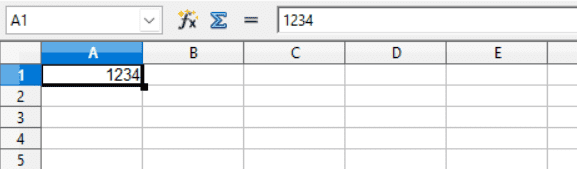

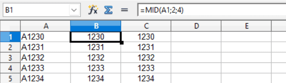

Well this is disappointing.
It appears that a derived field does not want to be formatted as a number, so I can't MATCH it.
My Search data:
Spreadsheet screenshot in OpenOffice Calc showing cell A1 selected, containing the number 1234 right-aligned, with the formula bar displaying 1234.
My Array to be searched:
Spreadsheet screenshot showing cell B1 selected with formula =MID(A1;2;4). Column A holds A1230 to A1234, column B shows 1230 to 1234 extracted by the formula, and column C shows the same numbers as plain values.
Column B is derived from column A.
Column C is flat numbers (as a control).

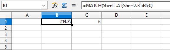

The results:
Spreadsheet screenshot showing cell B1 with formula =MATCH(Sheet1.A1;Sheet2.B1:B6;0) returning #N/A, and cell C1 showing the value 5.
Column B cannot find a MATCH to the derived number, even though they're both formatted as 'number'.
Column C (the control) MATCHes fine.
I am stumped.

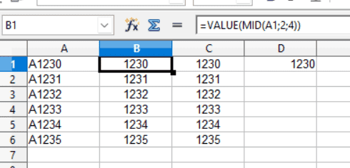

pbuk said:
Yes, that will give a string (text). Convert it to a number with VALUE(MID(A1;3;10)).
Ah. @pbuk solved that already! Enclose it in VALUE(). (It also works to add +0)
Spreadsheet screenshot showing column A with entries A1230 to A1235, column B with formula =VALUE(MID(A1;2;4)) returning 1230 to 1235, and column C with the same numbers as plain values.

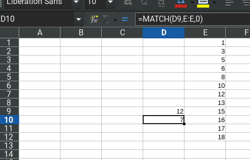

Dave, what was the formula you used in cell D1 of post #25? I'm using =MATCH(D1, B1:B5), but it just gives the (correct) index of the value I have in D1, of the column range B1 - B5.
I can't figure out how to use the index of a range to get the value there.
Tips for MATCH:
  • Always specify the final argument, which you most often want to be 0.
  • It is often best to MATCH on a whole column e.g. MATCH(D1,B:B), this avoids mistakes when you add more items to the list (and you should never put that formula in D1, or anywhere in column B as it would be a circular reference).
You could try INDEX :-p

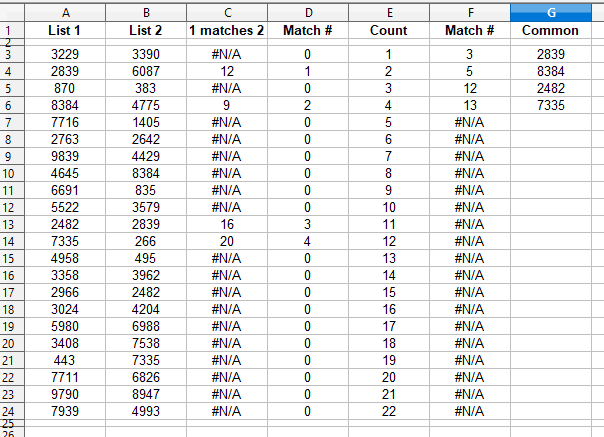

In that case I strongly recommend you use guard rows (the narrow rows in the sheet below - I downloaded the latest OpenOffice just for you!)
Spreadsheet with columns A to G: two lists of numbers, a column of #N/A and match numbers, a count column, and a Common column listing 2839, 8384, 2482 and 7335.
Coming up: the formulas to achieve this.
