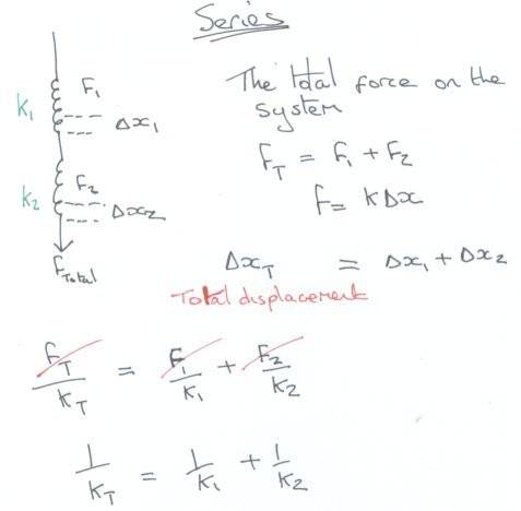

How do we derive the total spring constants of different mass spring systems
F= kΔx
I have just realized this is similar to this thread
https://www.physicsforums.com/showthread.php?t=711957

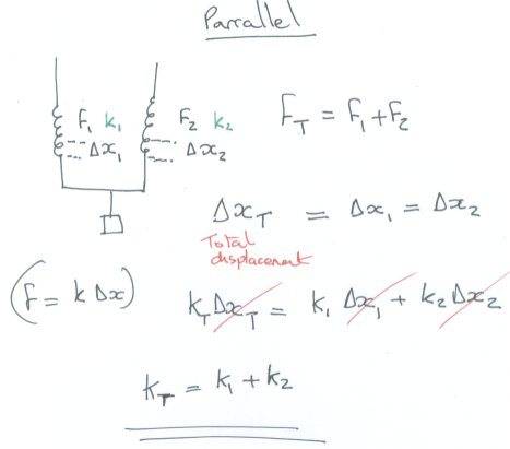

I was told to treat this as F1 = F2 and the displacements are equal.
I am struggling to convince myself that F(total) = F1=F2
any help gratefully received
In the parrallel case I can see how the displacement is the same but again I am confused by the forces.
I guess I need a couple of spring balances
