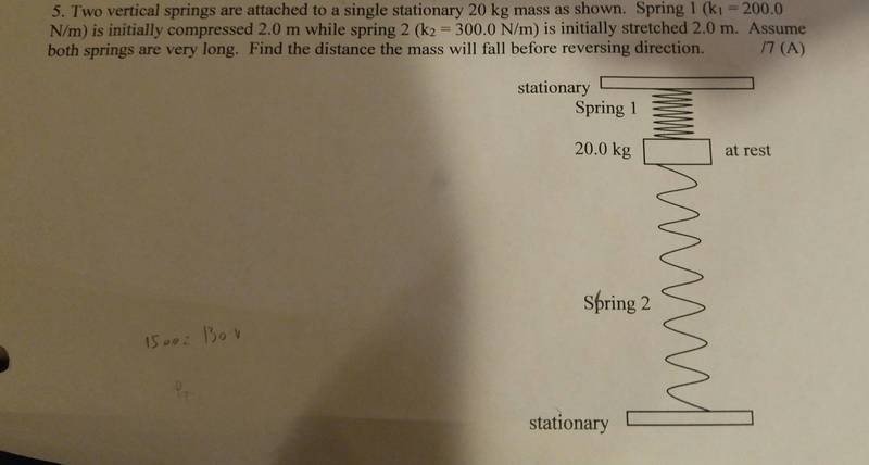

Diagram of a 20.0 kg mass hanging between two vertical springs: spring 1 attached to a stationary top support, spring 2 attached to a stationary bottom support, the mass at rest between them.
Et = Ek + Eg + Ee
Top:[/B]
Et=mgh+1/2k1 Δx12 +1/2k2Δx22
196h+400+600 = ET
Bottom:
Et=1/2k1Δx22+1/2k2Δx22
400+600=1000
...and that's when I realized I must have done something wrong. Sorry, I'm kind of bad at this stuff. Please help
Why do you think you have done something wrong?
h, I assume, is the distance the mass falls. What is the relationship between h and x2?
