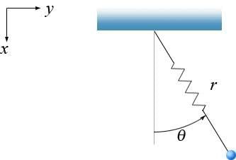

Consider a pendulum with a spring as in the following diagram:
Diagram of a spring pendulum with a blue bob at the lower right, a zigzag spring of length r hanging from a shaded ceiling, angle theta from the vertical, and x and y axes at the upper left.
Please note the 'rotated' coordinates.
The bob has a mass [itex]m[/itex]. The spring has a spring constant [itex]k[/itex] and an unextended length [itex]\ell[/itex]. We can not ignore air friction.
Assume the initial velocity and horizontal displacement are parallel, so that the motion of the pendulum is in the plane. It is not a 'spherical' pendulum.
I need to show that the equations of motion satisfy the following:
[tex]m\left( r'' - r (\theta ')^2 \right) + cr' + k(r-\ell) = mg \cos \theta[/tex]
[tex]m \left( r \theta '' + 2 r' \theta ' \right) + cr \theta ' = - mg \sin \theta[/tex]

I can use the Lagrangian to find the equations of motion, but I don't have a clue what to do with the friction force..??

In the case of dissipative forces, the Lagrangian is unchanged. However, the Euler-Lagrange equation changes.
The Euler-Lagrange equation is typically derived by extremizing the action:
[tex]\delta S = \delta\int{L(x, \dot x)} dt = 0[/tex]
However, another equivalent starting point is the "[URL principle[/URL], which states that the virtual work done by a system is 0.
The derivation from then on is relatively involved (Goldstein 3Ed pg16 - pg24), but one finds that if we assume that the force is conservative, we get the usual Euler-Lagrange equation. However, if we assume that the force has conservative and dissipative terms, we find out that the Euler-Lagrange equation equation needs to be modified by adding a dissipation function.
The results are summarized in this "www.phys.uri.edu/~gerhard/PHY520/mln9.pdf"[/URL].
In the end, what all this really means is just
[tex]\frac{d}{dt}\left(\frac{\partial L}{\partial \dot q_j}\right) - \frac{\partial L}{\partial q_j} = Q_j[/tex]
, where [tex]Q_j[/tex] is the dissipative force. Which is probably not surprising at all.
