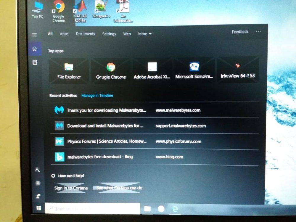

I own a HP Probook 450 G6, with Windows 10 Professional. The laptop was working properly till today morning. Now, when I started it this evening, I started getting spurious lines from MS edge. Chrome is displaying complete black screens.
Photo of a laptop screen showing the Physics Forums website in a browser with a Log in dialog box overlaid, with diagonal lines and a dark shadow distorting the display.
PF from MS Edge
Laptop screen showing a Chrome browser window at the top over a dark blue background, with white rectangular glitch artifacts and diagonal white streaks across the lower left.
Gmail from Chrome
Photo of a laptop screen showing a Chrome browser window on physicsforums.com with a bookmarks bar, and a mostly washed-out pale blue display with faint horizontal streak lines and a few small red marks.
PF from Chrome
Screenshot of the Windows 10 search panel showing top apps, recent activities including Malwarebytes and Physics Forums pages, with a desktop icon row and a cursor-free taskbar, photographed on a monitor.
While using search option from task bar.
I restarted several times, cleared cache, prefetch and temp folders, but without any luck. I just can't accept that the PC was running fine this morning, and maybe within 12 hours, these problems started. Malwarebytes and Windows security report a clean system without any virus.

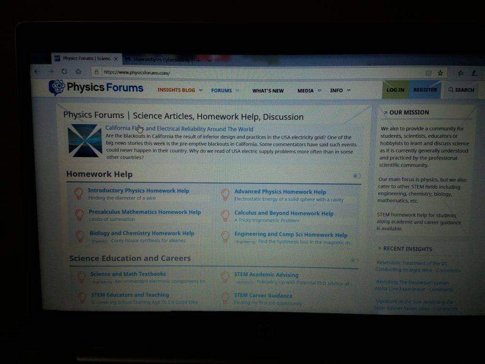

  • Photo of a laptop screen showing the Physics Forums homepage in a browser window, with the Homework Help and Science Education and Careers sections visible.

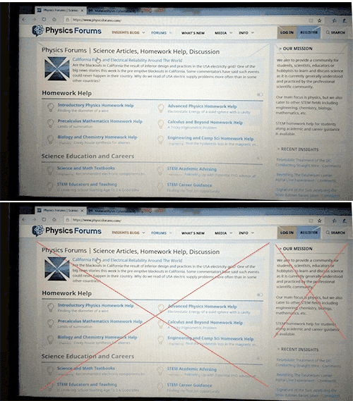

I don't think that's a video problem.
Those diagonal lines aren't spruious - they match the boxes created in HTML.
This suggests it has more to do with the browser than the hardware or drivers.
Two photos of a laptop screen showing the Physics Forums homepage in a browser; the lower photo has a red X drawn across it, with diagonal lines visible on the page.

Thanks for your input, @jedishrfu and @DaveC426913. The fact that the lines appeared even in start menu indicated that this might not be a browser-specific problem. I was frantically searching for a solution, and chanced upon this thread:
https://answers.microsoft.com/en-us...y-screen/a7ccaeca-50c5-41d3-8963-6c8ef7d5d702The advice given there was to roll back device drivers for graphic cards. I have two graphic cards - Intel and Nivida. Right-clicking the start menu, there is an option "Device Manager". From there, I rolled back the two device drivers, and Voila! Everything returned to normal.

Interesting glitch. Never seen that before. Gives a little bit of a peak into how the Desktop Windows Manager compositor maps image buffers onto quads and then gpu breaks them into triangles.
