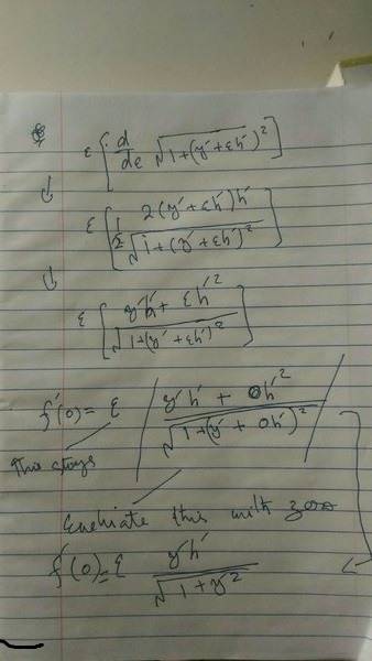

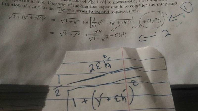

Hi,
I working on their text this equation did not make sense to me.
From equation 1 it differentiate second term , I wonder how he got second term of equation 2.
What I think is, what I wrote at the bottom
They are doing a Taylor series and writing ## f(x)=f(a)+f'(a)(x-a) +... ## In this case ## x=\epsilon ## and ## a=0 ##. ## \\ ## I agree with their result.
but how did they resolve
f(x)=f(a)+f′(a)(x−a)+..
to get second term in eq 2.
The chain rule. In numerator of ## f'(\epsilon) ## you have ## 2(y'+\epsilon h) h ##. You then compute ## f'(0) ##.

but then why there is no ϵh' term in denominator in second term in equation 2 ?
It should have stayed there.
and if were to consider ϵ = 0 then why there is still e multiplying second term in equation 2 ?

The ## \epsilon ## is from ## (x-a)=(\epsilon-0)= \epsilon ##. Meanwhile, the ## \epsilon h ## in tthe denominator gets put equal to zero as part of taking ## f'(0) ##. (The entire term is the product of both of these which is ## f'(0)(x-a) ##.)
So like this ?
