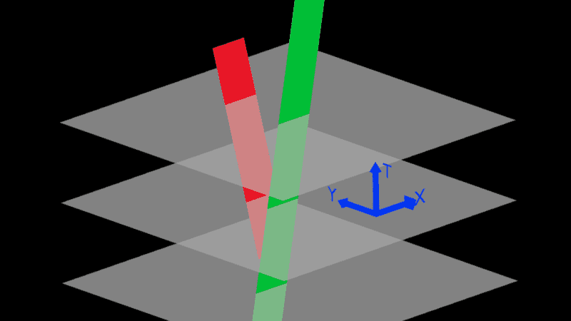

This may also be helpful - it's a (2+1)d Minkowski diagram showing the worldtube of one cart and its rising plate in C's frame.
The cart is green and the rising plate is red. Some planes of simultaneity are shown in translucent white, and you can see the red plate is further and further above (in the +y direction) the green plate as time increases. Note that the lines where the red and green worldsheets intersect the simultaneity planes are parallel, so the rising platform is horizontal in this frame.

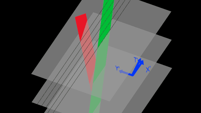

Now here's a diagram, still drawn in C's frame, but showing the simultaneity planes of A.
Here we see the exact same thing, but of course the relativity of simultaneity means that these planes of simultaneity are slanted with respect to the original ones. This time, we can see that the lines of intersection between the worldsheets and the simultaneity planes are not parallel. That might be more obvious if I add some lines parallel to the intersection of the green line and the simultaneity planes:
So the front of the rising platform is higher (larger y coordinate) than the rear of it using this definition of simultaneity. That change of definition of simultaneity is the origin of the slope of the platform - the cart length contracts but doesn't slope because its worldsheet lies in the ##t-x## and ##t'-x'## plane, while the platform with its worldsheet with extent in the ##y## direction does.
