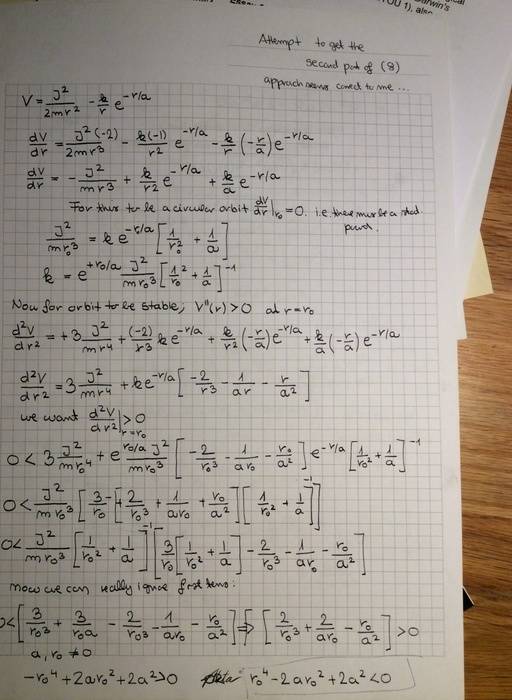

I have tried to solve the problem multiple times and obtained;
$$k=e^{r/a}*\dfrac{J^2}{mr^3}(\dfrac{1}{r^2}+\dfrac{1}{a})^{-1}$$
this lead me to the inequality;
$$ \sqrt{1+\sqrt{2}} \textgreater \dfrac{r}{a}$$Could anyone tell me whether my approach is correct ??
Thank you
What did you do to get that inequality?
What you were supposed to do, as the statement of the problem said, was use the expression for k to remove k from the potential. Then take the second derivative of that expression, now with no k in it. Then determine what makes that second derivative greater than 0.
What did you do?
That is exactly what I have done; I am attaching a figure with my working;
Check your algebra when you take the first derivative. In particular, check what the derivative w.r.t. r of exp(-r/a) is.
Likes asdfghhjkl
Thank you for pointing this out, I cannot believe I made such a basic mistake.
