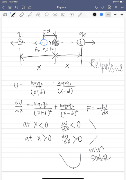

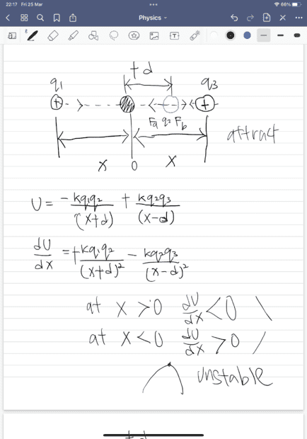

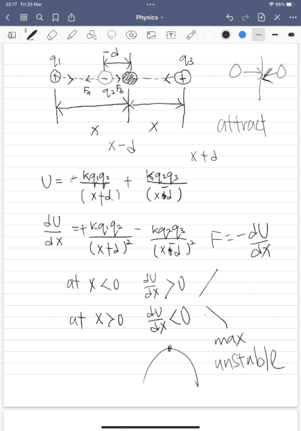

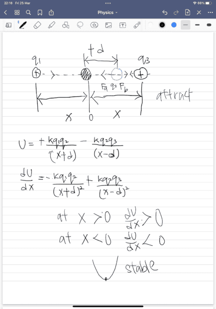

How to determine whether it is stable equilibrium or non stable equilibrium by using potential energy equation derivative
F=-dU/dX
F=kqQ/x^2
U=kqQ/x
Hi all ,
please refer to the picture regarding my working.
please correct me if My working is wrong.
I am quite confused about the positive and negative sign in equation

Your conclusion looks ok, but I do not understand your diagrams. They all seem to show a negative charge between two positives.
Also, a single diagram and expression for U will serve. The signs of the charge and the displacement need not be determined by that. You can break it into the various cases later.

Yes, I deduced that from your working, but it is not clear from the diagrams.
Also, I notice you are not assuming the two outside charges are the same, yet you do asume the equilibrium point is in the middle.
Please correct that (one way or the other) then insert a step that demonstrates more convincingly what sign dU/dx takes. Specifically, combine the two fractions into one, cancelling as appropriate.

You have not supplied the original problem statement as given to you, and you have not responded to the points I raised in post #6. Are q1 and q3 equal? If not, the equilibrium point will not be equidistant from them.
Assuming they are supposed to be equal, you wrote expressions like ##U=kq_1q_2(\frac 1{(x+d)}-\frac 1{(x-d)})##.
I am guilty of not having looked closely enough at your working there. There is no justification for the minus sign on the second term. The potential due to one charge is ##kq_2\frac 1{(x+d)}## and due to the other charge is ##kq_2\frac 1{(x-d)}##. These should be added, to produce ##U=kq_1q_2(\frac 1{(x+d)}+\frac 1{(x-d)})##.
Then you differentiated wrt x to produce ##dU/dx=-kq_1q_2(\frac 1{(x+d)^2}+\frac 1{(x-d)^2})##, but in your assignment of variables, x is the fixed distance and d is the variable distance (the displacement from the equilibrium position). So any derivatives should be wrt d, not x.
Since that would involve writing things like dU/dd, it gets very confusing, so let's swap these over. In your diagram, swap x and d. So we have ##U(x)=kq_1q_2(\frac 1{(d+x)}+\frac 1{(d-x)})##.
Now differentiating wrt x produces the desired sign difference:
##dU/dx=kq_1q_2(-\frac 1{(d+x)^2}+\frac 1{(d-x)^2})##.
In short, you got a reasonable expression for dU/dx by sheer luck.
Edit: corrected below (thanks @SammyS ):
The next step I tried to get you to do is to collapse that into a single fraction:
##dU/dx=kq_1q_2\frac{ (d+x)^2-(d-x)^2}{(d^2-x^2)^2}##.
The numerator simplifies a bit, so that you can see easily whether this is an increasing or decreasing function for small |x|. It is not necessary to take a second derivative.
Better still, don't take any derivatives. Collapsing the expression for U we get:
##U(x)=kq_1q_2(\frac{ (d+x)+(d-x)}{(d^2-x^2)})=kq_1q_2(\frac{ 2d}{(d^2-x^2)})##. It is clear that if the charges have the same sign then this increases no matter which way we move from x=0, so it represents a minimum energy.
