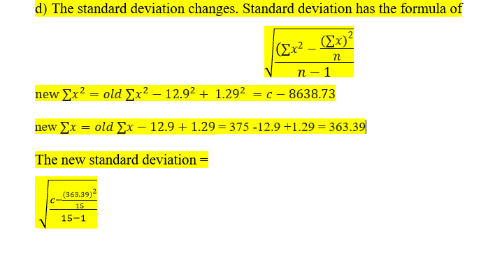

Here my ans , it's rather weird ... How to get the new standard deviation as function of the old one ?

Something went wrong with 12.9^2 (or elsewhere in that line).
You just followed one part of my suggestions.

which part is wrong ? can you point out ? I have checked thru the working , can't find which part is wrong
How do you get 8600 by squaring 12.9 and then subtracting something?
