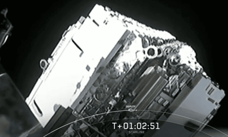

Success. Although I have no idea if the deployment of the satellites worked properly (SpaceX expects to have a confirmation in a few hours). It was unlike any other satellite deployment. They just stacked 60 satellites (in two groups of 30 apparently) and let them slide apart from inertia.
Shortly after deployment:
Black-and-white video frame of a stack of Starlink satellites on a dark background, with a DEPLOY marker and the timer T+01:02:51 and STARLINK label overlaid at the bottom.

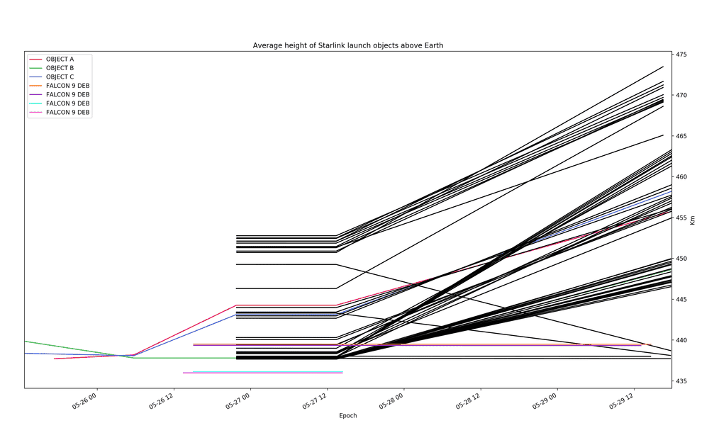

Graph based on NORAD tracking data:
Line graph of average height above Earth in km against epoch from 26 to 30 May 2019, with many black lines for Starlink objects climbing from about 440 km to between 450 and 477 km, plus four coloured flat lines near 440 km for Falcon 9 debris.
(edit: updated from here)
The fastest raise their orbit by 10 km/day but most are using a more relaxed 5 km/day. In total 64 objects are tracked, 60 satellites and 4 objects related to the release mechanism (they will burn up in the atmosphere over time). Here are observations of them
Meanwhile SpaceX revealed that 56 satellites are fine while 4 have some trouble, but it is unclear which kind of trouble. Can't be too bad if they decided to raise their orbit.
Edit: With more clarification which object is what it looks like only 56 satellites raise their orbit. Two lowered their orbit, two more don't raise it.
Edit: Yet another update. The first satellites made it half the way to their final orbit now. 57 satellites are raised now (that number was 56 before), it looks like the issue of one of them could be resolved.
  • Line graph of average height above Earth in km against epoch from 26 May to 29 May, showing Starlink launch objects climbing from about 438 km to between 440 and 475 km, with a few tracks falling or staying flat.
Still a lot of confusion about tracking, but it is now quite clear that one satellite is actively lowering its orbit. Probably one of the four with issues, if SpaceX decided they can't use it then deorbiting it actively is the best option. Meanwhile the good satellites are reaching their target altitude of 550 km - the first few seem to be there (or very close), most of the rest can catch up within a week or so. They might keep some a bit lower deliberately to spread the satellites out in their orbital plane. Ideally they all have circumference/56 distance to each other (or whatever number of satellites will be useful if not 56).
