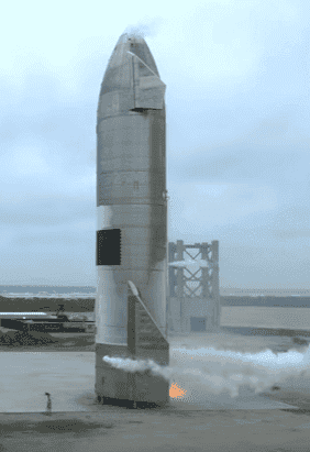

  • #78
Soft landing. A bit of fire but that was extinguished.
They'll study this one in detail. Maybe we'll see it fly again in the future.Edit: Musk: Might try to refly SN15 soon
