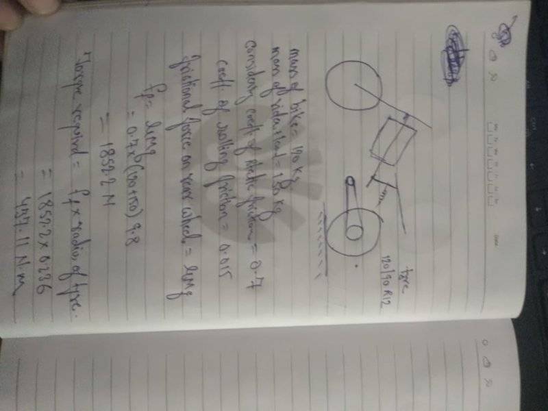

hey everyone I'm interested in finding the starting torque of a bike weighing 120 kg with a load of 150 kg and having the tire specification of 120/70 R17.
starting torque means the amount of torque i need to provide to wheel in order to start moving the bike from rest. power source is a 4kw motor.

my problem is...my bike is standing with a load mentioned now i want my bike to move on the road,so i think static resistance will come into play.i'm confused about how much friction force does the motor have to overcome when it will rotate the rear wheel.

im asking for starting torque because it want to know the reduction ratio i have to provide coz my motor is providing me a peak torque of 20 nm

am i doing it right?

By your calculations it will take a 1852.2 N force to get the bike moving. Does this seem reasonable to you?
that's what I'm asking what am i doing wrong?
First- Where did you get the values for the Coefficient of Friction and the Coefficient of Rolling Resistance you used in your calculations and why do you think they apply to this situation?
Second- Are you trying to apply the famous equation F=ma to solve this situation and why do you feel it applies here.
Thirdly- What do you understand that the stated Coefficients mean, in very practical terms.
Fourth- Are you allowing the need for a purely mathematical solution to cloud your perception of the practical approach for solving the problem?
Fifth- Have you drawn an accurate force diagram of the problem at hand?
Sixth: Have you considered all the possible mitigating factors that might effect the solution’s final values?
Seventh- Do you feel you understand the difference between friction and rolling forces?
What you did in your calculations is not «the amount of torque you need to provide to the wheel in order to start moving the bike from rest», but it is what you are looking for.
The torque you will provide to the wheel will, first, fight the rolling resistance. If the torque input exceeds that, then it will start to accelerate the vehicle. How fast it will accelerate is proportional to the amount of torque in excess. First question on your mind would be, how fast do I want to accelerate?
The answer to this question is usually: As fast as I can.
What will limit your acceleration is the maximum friction force available between the tire and ground; Which is what you calculated. Above that threshold, you will accelerate the wheel (spinning), but not the vehicle.
The only mistake you made in your calculations is that you took the total mass of the bike, but only the rear wheel is powered, so only the portion resting on that wheel should be considered as the normal force.
