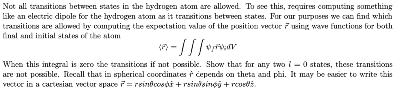

Show that for any two l = 0 states, these transitions are not possible.
expectation value
Printed text describing a hydrogen atom problem: transitions between states are not all allowed, found by computing the expectation value of the position vector using wave functions, shown as the triple integral of psi_f times r times psi_i dV, with a Cartesian form of r given for l = 0 states.

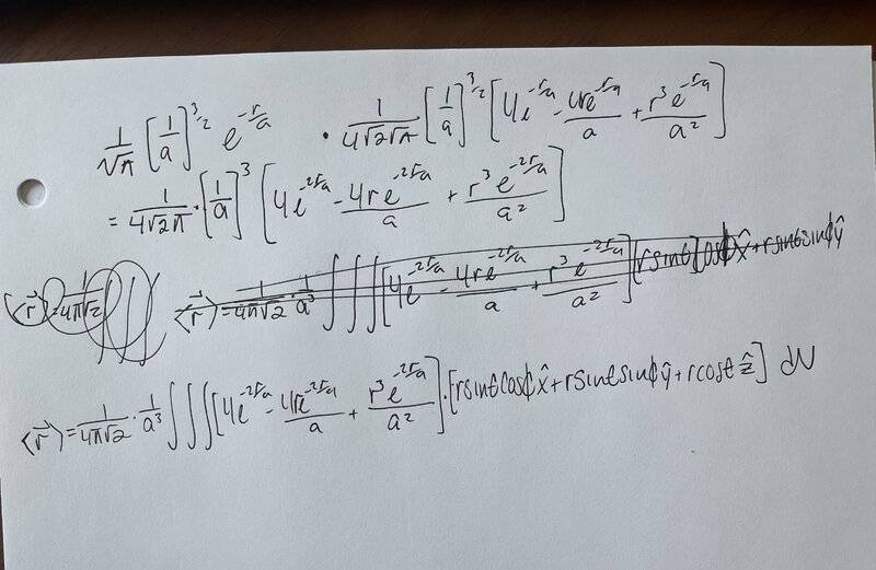

I am a little lost on how to approach this problem.
What I know is the following:
The r vector is in terms of x y and z hat.
I know my two l=0 states can be the 1s and 2s normalized wave function for Hydrogen.
Should I be integrating over dxdydz?
Handwritten derivation of the expectation value <r> using 1s and 2s hydrogen wavefunctions, with a triple integral over dV of spherical coordinate expressions multiplied by r-hat vectors.
What is significative of the ##l=0## states as functions of the spherical coordinates?
l=0 states mean the orbitals are the shape of a sphere. Ok that's illuminating, so I should be integrating in spherical coordinates, r2sinθdrdθφ. So r should be from 0→∞.
I feel like I am still missing something. If I multiply this out its going to be a mess.
