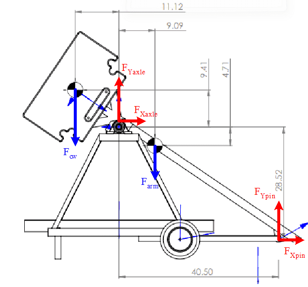

The goal is to calculate the static forces in the throwing arm of the trebuchet when it's pinned as shown in the image. The counterweight is equal to 1435 Newtons. The mass of the arm is equal to 114 Newtons. Dimensions are shown in inches. The pin is in double shear since it passes through three plates.
∑M, ∑Fx, ∑Fy
∑MAxle = (1435 N)(11.12") - (114 N)(9.09") + (FYPin)(49.59") - (FXPin)(33.23") = 0
∑Fy = -1435 - 114 + FYAxle + FYPin = 0
∑Fx = -FXAxle + FXPin = 0
So this is where I'm stuck. If FXAxle = FXPin then I'm left with 2 equations and 3 unknown values. And there's no moments about the axle correct? - since it rotates freely? Any advice would be greatly appreciated.

Thanks for the heads up. I've attached the pdf file. I've also added one more equation:
ΣMPin = (1435 N)(60.71") - (FYAxle)(49.59") + (FXAxle)(33.23") + (114 N)(40.5") = 0.
So this gives me four equations and four unknowns. This will allow me to solve for the X and Y forces at the pin and at the axle correct?

I would think so, yes, so long as you've got all the signs and distances correct for all your moments. For example, in your first equation how did you decide on the signs and distances for your FYpin and FXpin?
Note the lines of action of the Fpin forces:

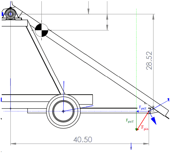

Hi, sorry my replies are few and far between. Dead week is aptly named. I've learned that I can treat the force at the pin as just one resultant force, perpendicular to the throwing arm. So I have three equations and three unknowns. I found the angle by taking the arctan(vertical distance from pin to axle/horizontal distance from pin to axle) = arctan(28.52/40.50) = 31.15°. I then found the complementary angle 90° - 31.15° = 54.85°. I also used the original units of lbs since those were the original units and are a bit easier for me to understand. The three equations are:
ΣFx = Fxaxle - Fpin*cos(54.85) = 0
ΣFy = Fyaxle - Fpin*sin(54.85) - 322.5 lbs - 25.74 lbs
+CCWΣMpin = (322.5 lbs)(52.62") - (Fyaxle)(40.50") - (Fxaxle)(28.52") + (25.74 lbs)(31.41") = 0
Solving, I get:
403.57 lbs for Fyaxle
67.68 lbs for Fpin
38.96 lbs for Fxaxle
I believe these are the correct values.
