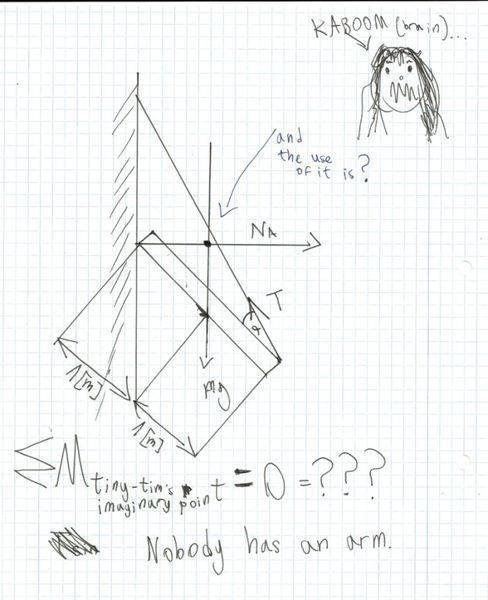

Dory: Let the vertical distance between point A and C be an unknown. You have three unknowns, and you can write three equilibrium equations. The summation of moment equation can be about any point you prefer. After you create your three equilibrium equations, solve the three equations for the three unknowns.
  • #36
I can't get to the point of 3 equations and 3 unknowns because I don't have AC and I don't have the angle...here, look, this is where I keep getting stuck at:
Sum of all moments on A = 0 = T(sin alpha) x 1.41 - mg x 1.41/2 = 0
Sum of all moments on B = 0 = -NA x 1.41 + mg 1.41/2 = 0
Sum of all moments on mg = 0 ; -Na(cos45) x 1 + T(sin alpha) x 1 = 0
I don't know how to include AC is one of the unknowns...regardless, since the angle is also an unknown I don't see how can this be solved...

There's usually no reason to take moments (of forces on the same body) about two different points (the second equation usually doesn't give any extra information that can't more easily be obtained from a linear equation) …
take moments about one point, and use linear components of force to get the other equations …
in this case, the moments about A (i don't think yours are correct, btw) together with the two equations for x and y components should do it :wink:
however, it would be simpler in this case to notice that all three forces must go through the same point (otherwise the moment about anyone meeting point would be non-zero) …
so you can re-draw the diagram so that the wire goes through the meeting point of the nomal force and the weight, and finding the angle then become a pure geometry question! :smile:

Do you mean https://www.physicsforums.com/attachment.php?attachmentid=31884&d=1296732455", in post #27, with the cute picture of you?
But your T there doesn't go through the black dot … the forces should all meet there, which is immediately gives you tanα = 2. :smile:

Let's review the options:
You can take moments about that dot, which gives you α geometrically, and then you can find T from the y components.
You can take moments about some other point, such as A, which gives you an equation for T and α, and then again use the y components to get another equation for T and α (or use a vector triangle ).
But then, there is no point where all the forces meet! Presuming my diagram is correct, those forces will go on forever and never meet at 3 places. There are 2 forces that meet at 2 points, though...
"presuming"?! :rolleyes:
Dory, your diagram is wrong! :smile:
… I want to get the geometry way right first. Sounds easier... "sounds"...
It is easier …
but you seem to have such an aversion to drawing forces on diagrams that you can't bring yourself to drawing three together! :redface:
Right, the diagram (where I've drawn myself) is wrong, but the last pic I've uploaded is of a triangle presuming that all 3 points meet somewhere between C and B. I only know for a fact it's a right triangle since NA and MG are straight lines...what of T... how can I find it out if I only have 1 angle (90) and 1 force known.
It is easier …
No no...no aversion! here!

Then why is your diagram so wonky?
Dory, I've decided that you need a lesson in drawing :wink:
Draw the wall first.
Draw the beam at 45°, to go exactly 8 squares horizontally (as you've done).
Draw the vertical line through the centre of the beam (yes! it can be drawn vertically! :rolleyes:).
Draw the horizontal line from the top of the beam, to meet the vertical line.
Then say to yourself … "Since the beam is in equilibrium, the only three forces on it must all go through the same point, so I must draw the string through that point, if I can force myself to do it :redface: … yes I can! I can! I can! :-p" …
and then draw the string through that point, to the wall. :wink:
You should now have two triangles on the same base, one with twice the height of the other :smile:
