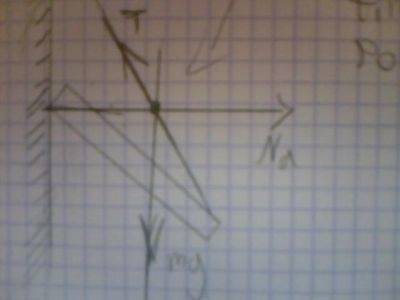

There are 3! Na (wall's normal), Bc (rope pulling) and mass x gravity (split in middle)...there, tiny-tim..you know I'll always make diagrams for you if you only ask! :) [sorry, can't use the scanner this late so quality sucks]
http://img716.imageshack.us/img716/9664/there11.jpg
Uploaded with ImageShack.us
I just wasn't sure how it helps me see the picture...should I build a triangle with these forces you suggest and I have the angles?
I know! :biggrin:
ok, now you have 3 lines of force …
they can meet in 3 points, or in one point …
which is it? :wink:

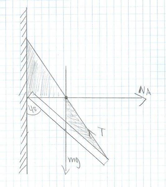

That one point is between C and B... I THINK. Technically you can move vectors around so I'm not sure as to significance of where they meet. I do see the significance of builing a triangle with them. Those 3 points are C, B, and the straight line I've drawn in red that connects B to the wall.
Dory said:
Technically you can move vectors around …
No!
You can move free vectors (like velocity) around (that's how we make vector triangles of velocities),
but you can't move bound vectors (like force) around …
a bound vector (I'm not sure that's the correct name, btw :redface:) has a line which is part of the vector
a force applied to the edge of something does not have the same effect as a force applied to the centre.
… so I'm not sure as to significance of where they meet.
Suppose a body in equilibrium has exactly 3 forces acting on it, and suppose that the three lines of force meet in 3 different points …
choose one of the points, and take moments (torques) of forces about that point …
what do you find? :wink:

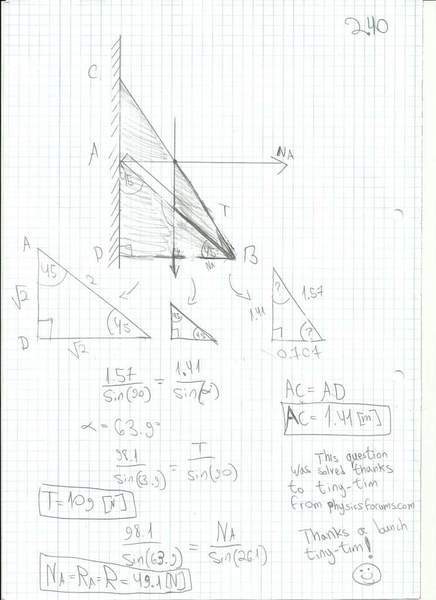

First off I used my better trigonometry to find AC = 1.41
Now I used the Law of Sines to find out that the angle between CB and AB is 24.11.
Now, being very excited and feeling close to the solution, I do this:
Sum of all moments on A = 0 ; Tsin(24.11) x 2 - mgcos(45) x 1 = 0
Then I see that the result of T is way off to what T should be ... then I get a myocardial infraction. :(
Is my equation correct?

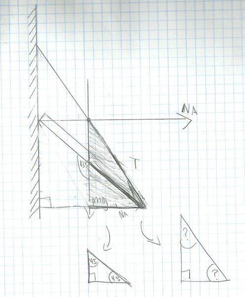

Then the normal force does not go through mg.
The normal force and the weight meet at the point vertically above mg and level with C
take moments (of all the forces on the beam) about that point.

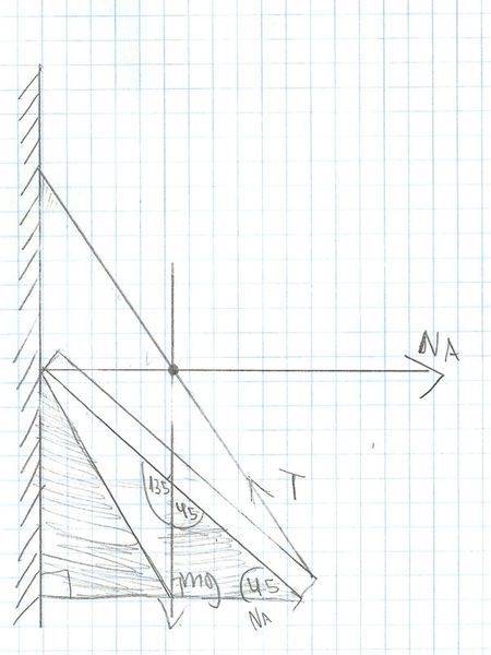

I see what you want me to do... I got the lengths by using the triangle at the bottom, but the problem is if I don't have the angle of T, I still can't solve it!
Please pretty please show me how you solve it? I promise I won't make it a habit it's just this horrific exercise...just this one time! (After looking at the solution I'll understand your logic)
Dory said:
I see what you want me to do... I got the lengths by using the triangle at the bottom …
Sorry, I have no idea what you mean. :confused:

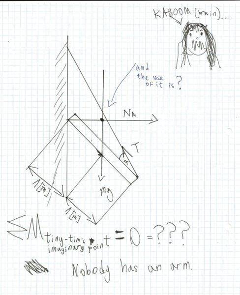

Please show us your diagram, including the lines of the normal force and the weight force, mark the points where they meet, and take moments about that point.
Dory: I can be wrong, but it seems to me like you are trying to find geometry first, physics later. It won't work. You know system is at equilibrium, write equations describing the equilibrium using unknown yet angles/lengths, and solve for them.
Fair enough, but this is all I can get going following you tiny-tim :P
Nice diagram! :smile:
ok, if ∑M = 0, then what is the contribution of T to that? :wink:
Heh, thanks, thought you might enjoy it ;)
Well, to answer your question, there's a tiny distance I think between your imaginary point and T's moment-causing vector to this point, but I don't know the angle, and I don't know T! How is it solvable again? *scratches head*
but you know that ∑M = 0 !
sooo … ? :smile:
