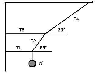

In the following diagram (see attachment), w=80N and the net force is 0.
I basically made two free body diagrams and applied Net Force = 0 for each axis, obtaining 4 equations with 4 variables (T1,T2,T3,T4). I got T1=56N T2=98N T3=115N T4=189N
However, my answers are apparently completely different from the "correct ones", which are: T1=37N, T2=88N, T3=77N, T4=139N.
I would like to know whether my answers are correct or not.
Help is appreciated! Thanks!
Either I've fat-fingered something with my calculator, or your answer for T2 (98N) is correct. I haven't checked any of the others, but they're all connected together so there isn't much point after you've found one wrong.
BTW, your method of solving the problem, although correct and the most general approach, is not the easiest. For this particular diagram, it's easier to start at the bottom and work up:
- What does T2 have to be to cancel out the vertical force from the weight?
- now that we know T2, what does T1 have to be to not have any horizontal aceleration?
- And work your way up to T3 and T4.
