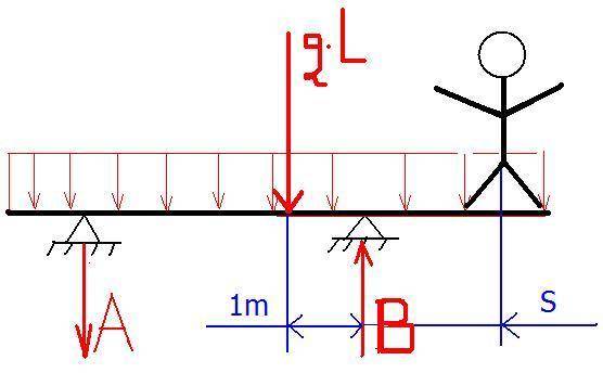

The uniform work platform, which has a mass per unit length of 28kg/m, is simply supported by cross rods A and B the 90-kg construction worker starts from point B and walks to the right. At what location S will the combined moment of the weights of the man and platform about point B be zero?
Platform illustration:
__A____________B___man (going to the right)___
Mass per unit length of bridge: 28kg/m
Mass of man: 90kg
Distance from far left end of bridge to A: 1m
Distance between A and B: 4m
Distance from B to far right end of bridge: 3m
Distance from B to man: S
M=d*F or M=r*F (cross product)
What I did was that I set point B to be (0,0) so any distances to the left of B is (-) and to the right will be (+). Also, I set all the weights to be (-) since it's going down the (-) y-axis.
Next I assigned the F from B to Man to be (90+28S) and the F from B to the remaining distance from Man to far right end of the bridge to be 28(3-S).
For the forces on the left side:
left end to A: 28
between A and B: 112
Next, I used M=d*F and set the moment of B from the left and right side to equal each other which leaves me with:
588=-90S-28S^2+(3-S)(-8.4+28S)
840=78S-56S^2
0=78S-56S^2-840
0=9.8(78S-56S^2-840) <-- to calculate weight
0=548.8S^2-764.4S+8232
When I try to solve for S, I use the quadratic formula but I can't solve for S because the number in the sqrt is (-) thus I can't solve for S. Am doing something wrong with the signs or is my approach completely wrong? Thanks for your help!

Do you know the solution? Maybe you should look at the platform as a seesaw without reaction in A. In that situation you would only have reaction in B plus the weight of the platform and the man. It would be easy to calculate the moment around B.
I don't have the solution sorry. What do you mean by reaction in B? If I disregard A does that mean that I'll just have a combined distance of 5 from the left side to point B and just calculate the total weight from that side? Thanks again.
I've attached a picture to explain what I mean. On my picture, force A i faced downward. That is a situation when this guy walks far enough to the right (over distance S as I have assumed). If this guy stands close enough to the point B, force A is facing upward. So I guessed that there has to be a situation when force A becomes zero before shifting it's orientation. My assumption is that that will happen when distance is S. I hope that somebody will answer with better idea.

Oh ok, at this point I thought that I can just ignore the forces on A b/c the question was asking about B. I'm still a little confused...sorry. It's a little hard to explain this via text only...lol
