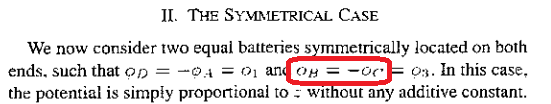

I see no indication in your paper (I don't have access to the full paper of Peters), what motivation the battery should have to provide extra electrons, if the wire is overall electrically neutral in it's rest frame.

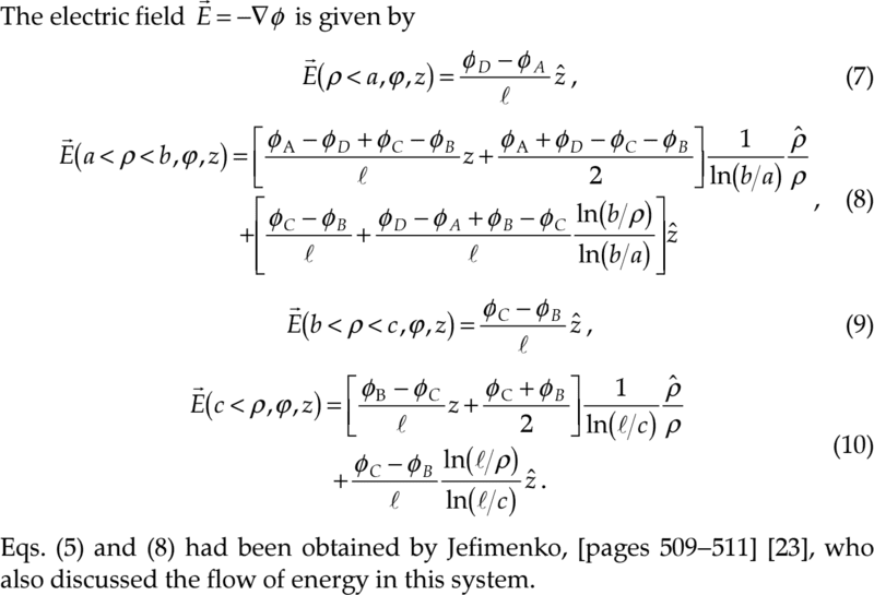

The only quibble I still have with my calculation is the homogeneous part of the ##\vec{E}##-field in ##z## direction in region IV (outside the coax cable), but it seems to be unavoidable from the continuity condition. On the other hand, intuitively, there shouldn't be a field outside the cable.
Sommerfeld avoids this problem in $17 by defining "outer radius ##c \rightarrow \infty##", from which follows his equation (3).
  • #42
Yes, but that's also pretty artificial ;-).

In the following paper, they don't make this somewhat artificial assumption. From their figure 3 follows the existence of longitudinal and radial components of the external electric field.
paper abstract said:
Surface charges and fields in a resistive coaxial cable carrying a constant current
Publisher: IEEE
A.K.T. Assis; J.I. Cisneros
Abstract:
We calculate the surface charges, potentials, and fields in a long cylindrical coaxial cable with inner and outer conductors of finite conductivities and finite areas carrying a constant current. It is shown that there is an electric field outside the return conductor.
Source:
https://ieeexplore.ieee.org/abstract/document/817391

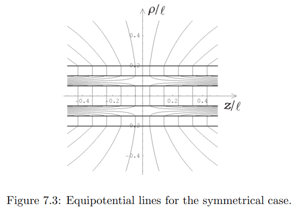

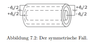

  • #45

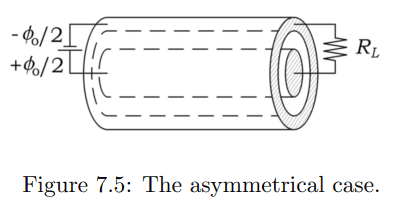

From the same author A.K.T. Assis exists also the following German book.
See on page 94, chapter 6.4 "Radialer Halleffect" and on page 105, chapter 7 "Koaxialkabel":
https://www.ifi.unicamp.br/~assis/Kraft.pdf
via:
https://www.ifi.unicamp.br/~assis/books.htm
Electrical field lines in the symmetrical case, according to the book:
Also, A.K.T. Assis mentions on page 8 of this book a here not yet discussed force of a wire on a charged test-particle at rest in the rest frame of the wire:
Das heißt, die externe Punktladung q induziert eine Verteilung von Ladungen längs der Oberfläche des Leiters und ergibt insgesamt eine elektrostatische Anziehung zwischen Leiter und q.
Google-translate:
That is, the external point charge q induces a distribution of charges along the surface of the conductor and results in an overall electrostatic attraction between the conductor and q.
From the publisher of this book, Apeiron, one can find also many dubious anti-SR books. However, that does not automatically mean, that every book of them is dubious.

Yes, that's exactly the solution I consider in my writeup (in the non-relativistic approximation, i.e., ##\vec{j}=\sigma \vec{E}##. My quibble is with (12). I come to another solution though (my Eq. (41)) by assuming that there should be no divergent component for ##R \rightarrow \infty##. That leaves a homogeneous electric field outside of the conductor. The math seems to be correct, but I'm a bit puzzled, whether this is the right physics.

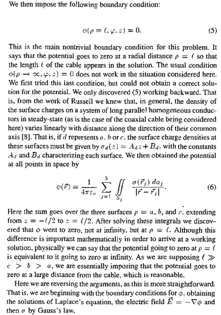

I didn't understand their boundary condition at ##\rho=L##. What has the longitudinal extent of a finite coax cable to do with the boundary conditions perpendicular to the conductors? There should be a boundary condition at ##\rho \rightarrow \infty## (##\rho## is my ##R##, i.e., the radial coordinate in cylinder coordinates).
Of course it would be desirable to have a solution for a conductor of finite length, but that seems to be too difficult for a closed, analytic solution.
Are their papers with a single wire (torus) around? Maybe that can be solved, but I guess it will involve some elliptic integrals or some other "higher functions", if it's solvable in closed form at all.
  • #50

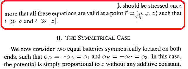

Yes, sorry, it's ##l## rather than ##L##. I don't understand the physics of their "fourth boundary condition", i.e., ##\Phi(\rho=l,\varphi,z)=0##. Where does this come from? What has the length of the wire to do with the radial boundary conditions?
All I use is the continuity of ##E_z## (the standard continuity condition of the parallel component of the electric field at boundaries). As my forth boundary condition I use that for ##\rho \rightarrow \infty## (using the paper's notation) the electric field must not diverge, and this leaves me with the constant electric field ##\vec{E}=-I/[\pi (c^2-b^2) \sigma]## (in the non-relativistic approximation, where ##\gamma=1+\mathcal{O}(\beta^2)##. In their Eq. (10) the electric field diverges logarithmically for ##\rho \rightarrow \infty##, which I find even more worrysome than my constant electric field for ##\rho>c##.
  • #51
They explain it under equation (5), but refer to Russell [8] to get an equation, that they use in equation (6) to get the justification for equation (5). Did you check their source Russell [8]?
Their equation (10) is only defined between ##a## and ##b##.

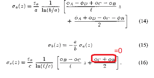

They explain it under equation (5), but refer to Russell [8] to get an equation, that they use in equation (6) to get the justification for equation (5). Did you check their source Russell [8]?Their equation (10) is only defined between ##a## and ##b##.
I guess we don't refer to the same paper. I talk about:
Assis, Cisneros, The problem of surface charges and fields in coaxial cables and its importance for relativistic physics, in "Open questions of relativistic physics", ed. by A. Selleri, Apeiron (1998)
The inner conductor's radius is ##a## and the inner and outer radiuses of the outer condutor are ##b## and ##c##. Here's the field he gives:
Then let's talk about the paper I was talking about. It contains at and behind equation (5) an answer to your question.
... is not a boundary condition at ...
vanhees71 said:
I think Assis's boundary condition at ##z=l##
Instead, it's a boundary condition at the surface of a thought cylinder with radius ##l##.
  • #55
But that's basically the same as the paper I've quoted. I still don't get the sense of this boundary condition. Also Russell's paper doesn't help. It seems as if they try to put two ideal voltage sources at the ends (one with potential difference ##\Phi_A-\Phi_B##, but on the other hand that doesn't coincide with what they give for these surface charges in Eqs. (14-16) in the IEEE paper. It's very puzzling...
  • #56
I don't see the problem.
Consider ##\text{radius} = l\gg c\gt b\gt a##:
  • #58
See free PDF in:
https://www.scielo.cl/scielo.php?pid=S0718-13372004000200003&script=sci_arttext
via:
https://www.ifi.unicamp.br/~assis/papers.htm
Another paper:
https://pubs.aip.org/aapt/ajp/artic...d-and-surface-charges?redirectedFrom=fulltext
Free version:
https://www.ifi.unicamp.br/~assis/Am-J-Phys-V71-p938-942(2003).pdf
  • #59
Visualization:
  • #60
I think in the IEEE paper is not OK, that they don't provide their mathematical calculation as evidence for the claim under equation (6):
IEEE paper said:
After solving these integrals we discovered that Φ went to zero not at infinity, but at ρ = ℓ.
