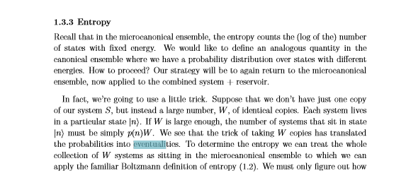

Hi
I am looking at the attached extract from David Tong's lecure notes on statistical phsyics
So we have a canonical ensemble system ##S##, and the idea is that we take ##W>>1## copies of the system ##S##, and the copies of ##W## taken together then can be treated as a microcanonical ensemble with energy ##W<E>##.
Each such copy lives in a state ##|n>##.
I am stuck on this part
' if ##W## is large enough the number of systems that sit in the state ##|n>## is ##p(n)W##' amd therefore we have 'translated probabilities into eventualities'.
MY QUESTIONS
Q1) I don't understand why ##W## is large is needed for ##p(n)W## to describe the number of systems that sit in state ##|n>##? Why doesn't this hold for small ##n##?
Q2)Also probably a stupid quesiton, but in what ways to the states ##|n>##, which physical properties are allowed to differ, since isn't the idea to take a large number ##W## of identical copies of the system ##S##, or do they not neeed to be identical?
In my opinion, statistical physics uses very cumbersome language because it wishes to use actual frequencies of events instead of dealing with probabilities of events. If we take a small number of systems (e.g. 3 systems ) and there are a large number possible states (e.g. 1000) , then even in the case where all the states have approximately the same probability of being occupied, only at most 3 of them would actually be occupied. So the observed frequency ratios would show many instances of 0/1000 instead of all of them being 1/1000. However, if take a large number of systems then the actual frequency ratios would probably all be close to 1/1000. (Physics wants to proceed on the assumption that the actual frequency ratios are definitely close to 1/1000. So, using the language of ensembles, we speak words that conclude by making this assumption.)
If we take the viewpoint of probability theory, we postulate there is a population of things, each of which is in one and only one of a set of states ##\mu_1, \mu_2,...\mu_N##. We assume there exist a set of variables ##P_1, P_2,..P_n## such that each member of the population is associated with one and only set of values of those variables. (i.e. a given member of the population "has" specific numerical values of ##P_1,P_2,...P_n##.
Given a specific numerical values of ##P_1,P_2,...P_n##, define the subpopulation ##W## to be the subset of the population such that each member of it associated with those specific numerical values. Define ##p(\mu_i)## to be the probability that a randomly selected member of ##W## is in state ##\mu_i##.
The members of ##W## are "identical" with respect to the numerical values of ##P_1,P_2,..P_n## that they have, but not identical with respect to which state ##\mu_i## that they are in.

So each system S has the same macroscopic properties, the ##P_i## above you've used.
I'm confused though, are the microstates of the microcanonical system each systems S, or do you also consider the microstates within each system S - so is the number of microstates for the microcananonical system W or NW? where N is the number of microstates of the canonical system S . If it's NW then that's fine. But if it is W, each is defined to be a canonical system itself, and all such systems, these copies of S, then agree macroscopically which has been taken as the microstates... ta
I'm not saying that each system in the entire population of systems has the same macroscopic properties, but, yes, I am saying that we define a sub-population ##W## so each member of ##W## has the same numerical values of the macroscopic properties. (The adjective "macroscopic" applies to the special situation thermodynamics. In the general scenario, the properties could be any numerical properties that fall short of specifying exactly which state the system is in.)
Each system ##S \in W## is in one and only one (micro-)state ##\mu_i##. Different members of ##W## can be in different microstates.
##W## is a set, not a number. In the above example, the number of microstates is denoted by an uppercase "N". The number of properties is denoted by a lower case "n". The number of elements in ##W## wasn't specified.
The goal of the notes you linked is to have the number of things in microstate ##\mu_i## be ## |W| p(\mu_i)## where "##|W|##" denotes the number of elements in the set ##W##.

##S## is defined to be a canonical ensemble.
Then for the definition of ensemble I have: copies of the same physical system, each in a different microstate, where typically the number of copies tends to infinity.
So because ##S## itself is a canonical ensemble, it is itself made up of the same copies of some physical system ?
