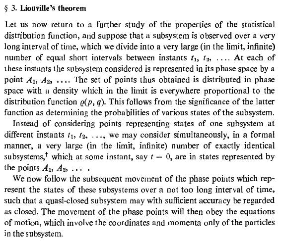

I've a question about the concept of ensemble is statistical physics.
Take a conservative system in a given macrostate (e.g. with a given energy): there will be a number of phase space's microstates compatible with the given macrostate.
If I understand it correctly, basically the microstates compatible with a given macrostate are all equiprobable. Therefore the probability to find a system in an infinitesimal volume of phase space is actually the density of microstates inside that chosen infinitesimal volume (density calculated w.r.t. the total number of compatible microstates).
What is an ensemble ? It should be a large set of compatible microstates inside a given phase space's volume. We can therefore imagine letting such "virtual systems" evolve according to the physics's laws verifying how the ensemble evolves along the phase space.
Does it make sense ? Thanks.

cianfa72 said:
I've seen the classic Landau's book of statistical physics.
Can you give a specific reference or quote from that book that you think describes what a statistical ensemble is?
Paragraph 3 in
L. D. Landau and E. M. Lifshitz, Course of Theoretical
Physics Volume V, Pergamon Press (1980).
cianfa72 said:
I think so
@vanhees71 has now given a quote (post #14) from the book you referenced, which includes the key footnote defining the term "statistical ensemble". Please compare with what you wrote in the OP of this thread.

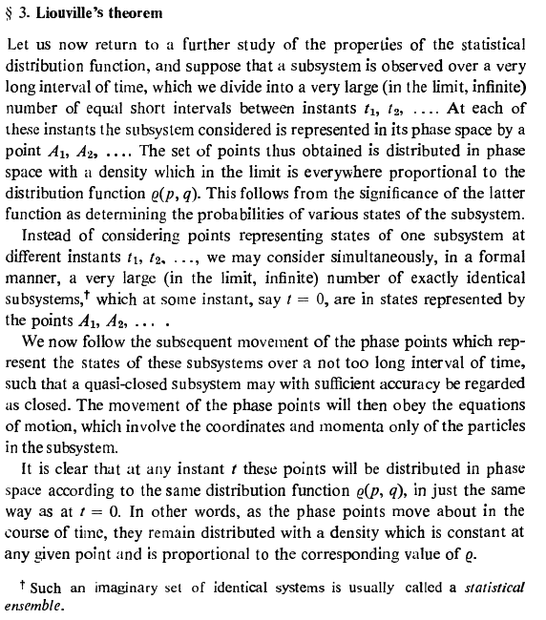

Note that this constraint (plus a constraint that the total number of particles is fixed) means that you are specifically dealing with the microcanonical ensemble. There are other types of ensembles corresponding to different sets of constraints. Gibb's classic book Elementary Principles of Statistical Mechanics was, AFAIK, the first to explicitly define the different types of ensembles.
Ok, now we can assume that all the microstates compatible with the given macrostate are all equiprobable. Therefore the number/density of compatible microstates inside an infinitesimal phase space's volume is proportional the distribution function (i.e. the probability to find the system inside that infinitesimal volume).
Now my doubt concerns the distribution chosen for the "virtual systems" in the ensemble. As far as I understand, they are chosen in such a way that their density at each point occupied from them in phase space is proportional to the distribution function.
The statement in the second quote above is correct, per the definition of the distribution function ##\rho## given in the text just prior to equation 1.4.
I'm not sure that is consistent with the first quote above.
The microcanonical ensemble consists of systems, each prepared in such a way that the additive conserved quantities take the given values such that each microstate is equally probable to be found when choosing a system randomly out of this ensemble.
Yes, however, given a finite assigned volume of phase space for the ensemble, the ensemble's virtual systems are actually distribuited inside that volume with a density proportional to the phase space's distribution function ##\rho## at time 0. Right ?
Reading this again, I think it means the virtual systems in the microcanonical ensemble are uniformly distributed only on the phase space's hypersurface of constant energy. That is, if the system has 2N degree of freedom, then the virtual systems in the microcanonical ensemble are equally distributed over the 2N-1 dimensional hypersurface of constant energy.
Reply
Exactly! The ensemble is defined by systems that fulfill the given constraints. For a equilibrium ensemble of a closed system these constraints are the values of the conserved additive quantities, particularly the energy.
