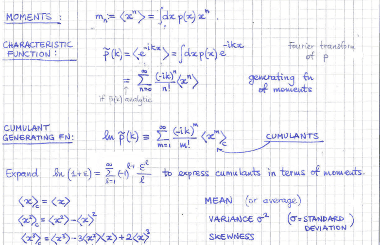

Using log taylor expansion to express cumulants in terms of moments
I have worked through the expansion- ##log(1+\epsilon)= ...## see thumbnail- and that's ok; my question is why does the expansion hold, i.e. all i can see is it must be that ##k## is small- how is this defined as so?
In all my studies on Fourier transforms, I don't ever recall talking about the size of the transform variable being small- (minus the exception of perhaps a boundary condition, and then k is a function of L and then as L gets large k is small) but why here would we require k small, and why isn't this mentioned?
my lectures notes here:
as above

The expansion
$$\ln(1+r) = \sum_{k=1}^{\infty} (-1)^{k-1} \frac{r^k}{k} \hspace{4ex}(1)$$ holds only for ##|r| < 1.## Thus, if you write
$$\rho(k) = 1 + \underbrace{\sum_{n=1}^{\infty} \frac{(-ik)^n}{n!} \langle x^n \rangle}_{=\;r}$$
you need ##|k|## small enough to ensure ##|r| < 1## in order to be able to apply expansion (1) to ##\tilde{\rho}(k) = \ln \rho(k).## (Since ##r = r(k)## is continuous in ##k## and vanishes when ##k=0##, there will be a ##k##-interval surrounding ##0## that ensures ##|r(k)| < 1## whenever ##k## lies in that interval.)

Thank you for your reply, and where is it assumed in the notes that k is small enough ? Is this a common sort of assumption with Fourier transforms or not ? Ta.

No: the Fourier transform may exist for all ##k##, and the series (1) may also be valid for all ##k##. However, as I said already (and will repeat here), the expansion ##\ln(1+r) = \sum_{k \geq 1} (-1) ^{k-1} r^k/k## is valid only if ##-1 < r \leq 1.## Therefore, when you write ##\rho(k) = 1 + r(k)## --- where ##r(k)## is the characteristic series for terms ##k^n, \; n \geq 1## --- we need ##|k|## small enough that we have ##|r(k)| < 1.## Just how large ##k## is allowed to be depends on the probability distribution, but for most distributions there will be at least a small ##k##-interval around ##0## that will work.
As for where in your notes it is assumed that ##k## is small enough: I cannot say. Maybe they do not say it anywhere---I cannot tell. All I can do is explain the situation to you as I have done: in typical case, having ##k## small enough ensures that ##|r(k)| < 1## and that allows your ##\ln##-function expansion.
