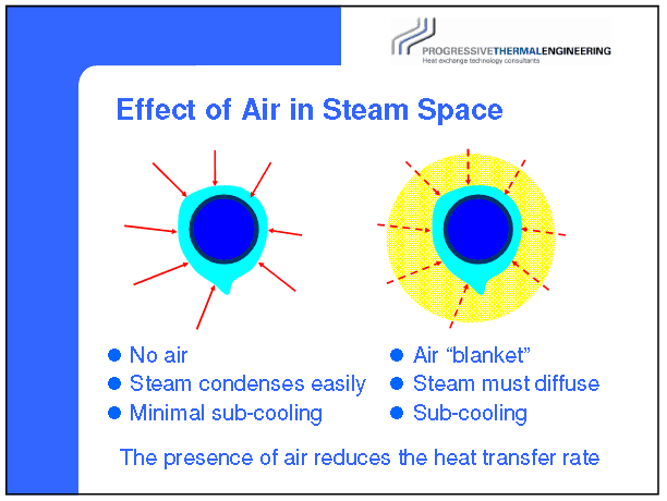

The condensate drain from a steam condenser is expected to be about 50 deg C. It's only 38 deg C or so. There's a mix of steam and non condensable gases coming into the condenser. Its pressure seems slightly higher, being about 0.25 bar abs instead of 0.2 bar. What does it indicate? Also, no significant difference in cooling water flow and the inlet outlet temps, compared to other healthy units under similar load conditions.

How's the air ingress on those other units?
In a condenser, steam flowing toward the tubes should reheat the water dripping from them back up to nearly saturation.
Too much air interferes with that.
Our condenser had trays interspersed in the tube bundle to catch the condensate and route it out of the tubes on an inclined plane, providing lots of surface area for heat transfer from incoming steam. That brings condensate back closer to saturation temperature.
image courtesy of these guys
http://www.hts.org.uk/downloads/TroubleshootingSteamSurfaceCondensers.pdf
