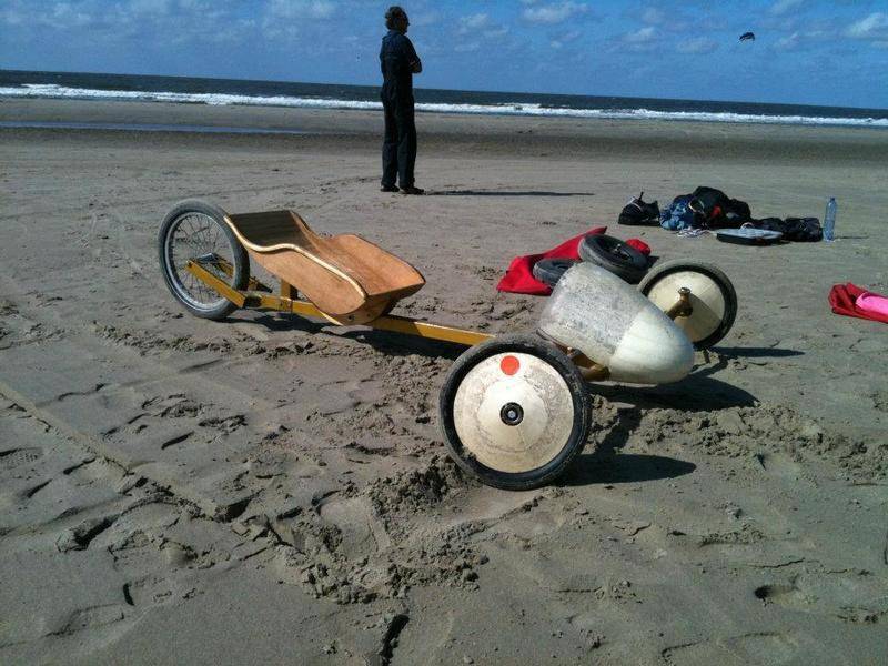

center 500lb how much bend will there be

Which orientation to the load?

What is the application? What is your background in Mechanical Engineering?
this is what i am looking to make its a kite buggy i am a big guy at 350lb
Size O.D. Wall
3" x 2" x 0.1875
3" x 2" x 0.125
5ft long
would like to know what steel square tubing would be best i am hoping i can use 3" x 2" x 0.125
That's a bit of a "stress riser" under the seat for that large a dynamic load; any way to simply clamp that with "U-bolts?"
