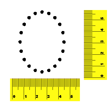

There are two ways of looking at it which in this case I think are just a change of coordinates, i.e. no change to the physics. In another situation, I think there is a difference but that is for another day. I've taken a screen grab of the Wikipedia animation and added rulers (I don't have time to animate it at the moment, I'm on a lunch break).
On Wikipedia, the ring of particles oscillates while the rulers are static. The alternative is that the ring is motionless and the rulers get stretched, one expanding while the other shrinks. I got the impression that these two visualisations were what Ibix was comparing:
Ibix said:
Normally Feynman's beads are described in terms of the beads moving on a rigid rod. ... Since we would expect stresses in a metal rod (length 1m, speed of sound ~1km/s) to relax away in a few milliseconds, it can be treated as rigid.
If you think of the rod in the discussion as having ruler marking on it, the usual picture is the beads moving along a rigid ruler, but the alternative is to consider the beads as unmoving and the rod shrinking and stretching within them.

In the first view, the rod magically jumps to a new (proper?) length instantly then relaxes back to its usual value. In the second view, the coordinate length stays the same when the step changes in the metric occurs but it then relaxes to a new coordinate length (back to the original proper length).
The problem is that the verbal descriptions depend on the choice of coordinates even though the physics being described is the same all the time.
