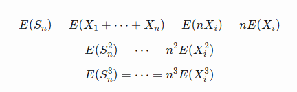

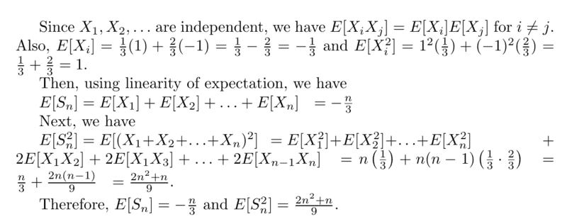

Suppose ##X_1,X_2 \dots ## are independent random variables with ##\mathbb{P}[X_j= 1] =1- \mathbb{P}[X_j=-1]=\frac13## Let ## S_n = X_1 +\dots +X_n## Find ## \mathbb{E}[S_n], \mathbb{E}[S^2_n], \mathbb{E}[S^3_n]##
Not applicable
Are my following answers correct?

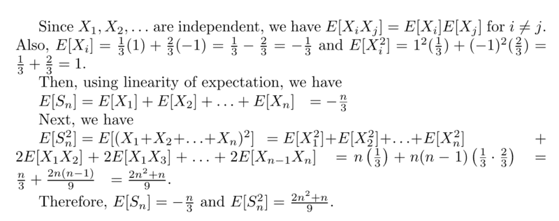

Handwritten-style typeset derivation of expectations for independent variables X1, X2, ..., Xn taking values 1 and -1 with probabilities 1/3 and 2/3, computing E[Sn] = -n/3 and E[Sn^2] = (2n^2+n)/9.

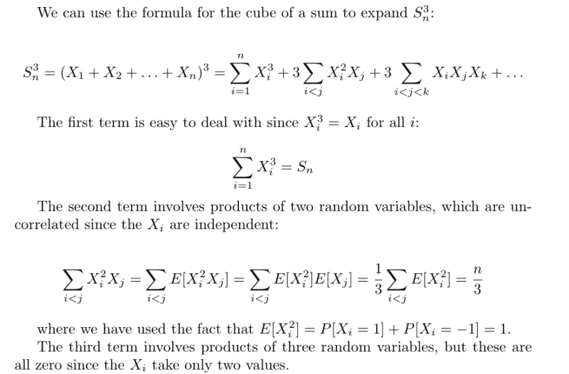

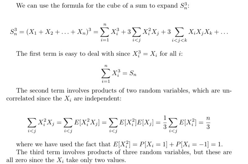

Typeset derivation expanding the cube of a sum S_n^3 = (X1 + ... + Xn)^3 using sums of X_i^3, X_i^2 X_j and X_i X_j X_k terms, with the expectation of the second term evaluated to n/3.

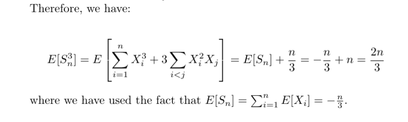

Typeset derivation: E[S_n^3] = E[sum X_i^3 + 3 sum_{i<j} X_i^2 X_j] = E[S_n] + n/3 = -n/3 + n = 2n/3, followed by the note that E[S_n] = sum E[X_i] = -n/3.
Have you tried the simple expedient of substituting some values of n and seeing if you get the right answer? Try n=1 to start.
You are making some careless mistakes
e.g. the expression for E(S2) should be n(1) + n(n-1)(1/9)
Your statement about the product of 3 random variables makes no sense; they are certainly not equal to zero. Each of the 3 random variables may independently take either of the values 1 or -1.

I agree with mjc -- hey, it rhymes!
You can't treat a multinomial ## ( X_1+X_2+....+X_n)^2## as a standard binomial ##( X_1+X_2)^2##. Look up multinomial coefficients.

No, they are not. The answer for E(Sn2) is wrong for n = 2, and that for E(Sn3) is wrong for n = 3.
The answer you gave in post #4 for E(Sn2) is right, but the answer for E(Sn3) is not. You didn't show your working, but I suspect the mistake may lie in enumerating the terms of different kinds.
There are n terms of the form Xi3, each of which has expectation -1/3.
There are 3n(n-1) terms of the form Xi2Xj, each of which has expectation -1/3*1.
There are n(n-1)(n-2) terms of the form XiXjXk, each of which has expectation -1/27.
(Check that the total number of terms is n3.)
Sorry to insist on this, but I suggest you check multinomial coefficients , to determine how to expand multinomials ##( x_1+x_2+...+x_k)^n##. I suspect the errors may be partially due to this.
